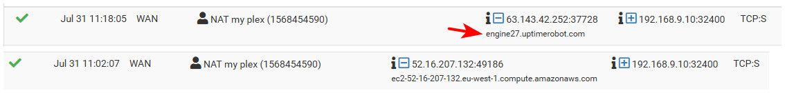

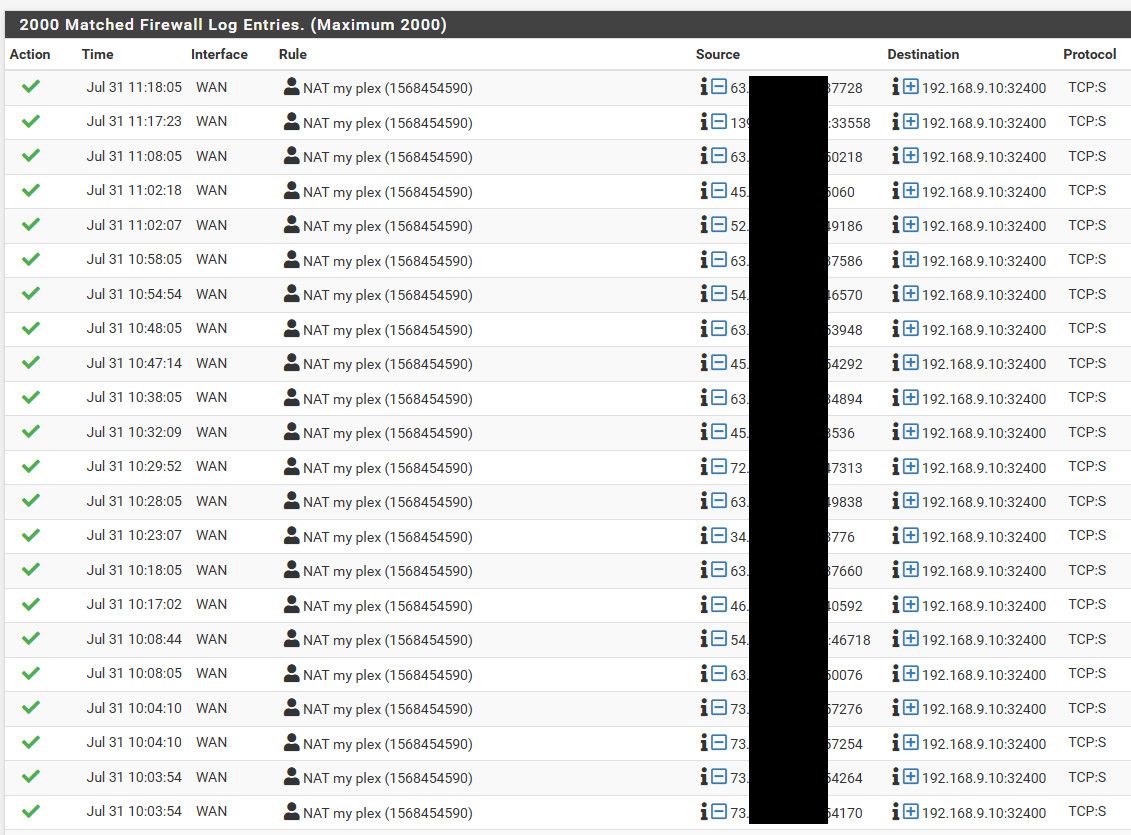

                here is example - I don't care to keep logs going back x number days.. As long as have current for the last 24 hours or so I am fine.. So for example here is IP that have recently accessed my plex server, either being my users IPs, or the status checks I do from outside that test if my plex is up. Or the check plex does now and then to validate remote access is available when you enable that..
                Here are example of like the uptime robot check, and the other one is plex checking that its remote available when you enable that - it checks now and then..
