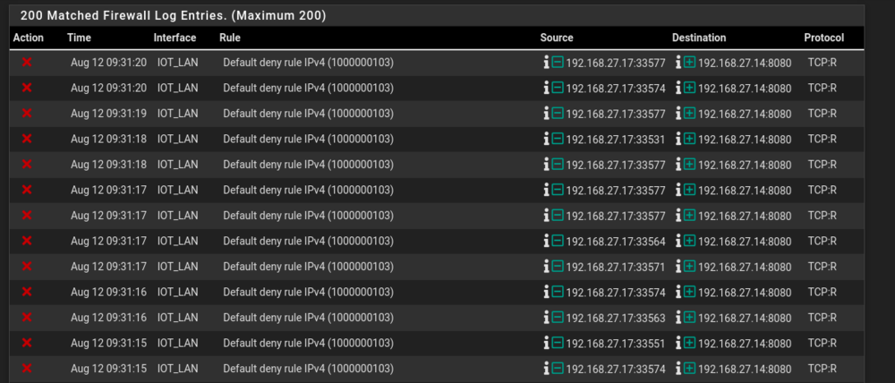

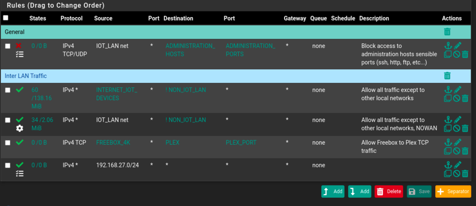

              Before handling the reply from the modem, I'm still having issue at the VLAN interface level. Despite a rule to allow traffic coming from the 192.168.27.0/24 subnet, connections are still blocked by the default deny rule. Even if there is no reply, I should not see this traffic blocked, right ?

                The traffic you're seeing blocked there is all flagged TCP RESET. It's blocked because pfSense has either not seen the initial traffic opening the TCP connection or that state has already timed out.
                https://docs.netgate.com/pfsense/en/latest/troubleshooting/log-filter-blocked.html#troubleshooting-blocked-log-entries-for-legitimate-connection-packets
                Additionally here though the source and destination appear to be in the same subnet. Unless pfSense has 192.168.27.14 I would not expect to see that traffic going through the firewall at all.
