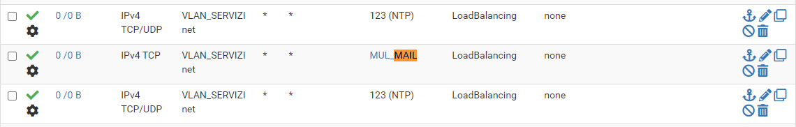

I am using PFSense 2.52 with tri WAN configuration.Everything works fine until some months ago. Now I see that rules with Policy Based Routing didn't work anymore.
The traffic specified in rule pass correctly but ignore the gateway selected and use the default gateway of PFsense.
If I disabled a rule the traffic not pass anymore, so the rule is working. But don't work only the PBR.
I notiche that the stats of rules that have PBR enabled still to 0/0 like this
other rules without PBR have the stats counter correct
I can't undestand where is the problem...
Looks like the traffic isn't matching, but seems like it would be helpful to see the bigger picture. Post the full pic of your rules from each interface.
What subnet is VLAN_SERVIZI net? Where are you testing from and how are you testing? What ports are in the MUL_MAIL alias?

After a lot of searching I found the issue,
I had to be enable the "Disable Negate rule on policy routing rules" in "Advanced -> Firewall & NAT" because in negate_networks tables I found the 0.0.0.0 networks (it is in that table because I created a IPSEC VPN with 0.0.0.0 in remote subnet of phase 2).But I couldn't undestand what the option "Disable Negate rule on policy routing rules" does. What is negate rule?
