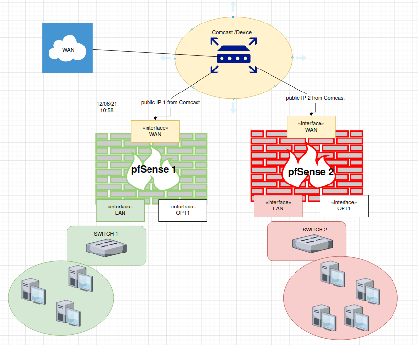

                josephchrzempiec
                Hello, Here is a image of my setup not the best drawing but I have tried my best. on the my main one is 10.1.151.1 the second router is 1692.168.0.1 Both have same subnetmask 255.255.255.0
                Mysetup
                noplanN 1 Reply Last reply Reply Quote 0

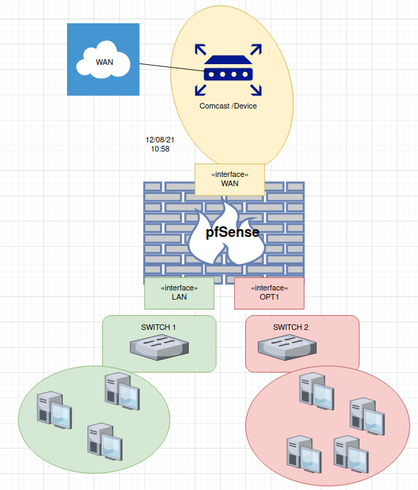

                  noplan @josephchrzempiec
                  @josephchrzempiec
                  Hi there try it this way !
                  WAN yellow is whatever comcast serves to you
                  LAN green is your net.
                  OPT1 red is his net.
                  let us know if this helps ...
                  your original version here:
                    Yes, using a single pfSense instance with multiple interfaces will give you the most control over the traffic between them. You can pass or block whatever you need.
                    If you want to have a 2nd pfSense and use a static WAN IP in the same subnet as the first pfSense then it will need to be connected the same way. So that will either be directly to the comcast device or via some type of bridged setup through the first one.
                    • noplanN Offline
                      noplan @stephenw10
                      start with this one first ;) before runnin down the road with a bridge
