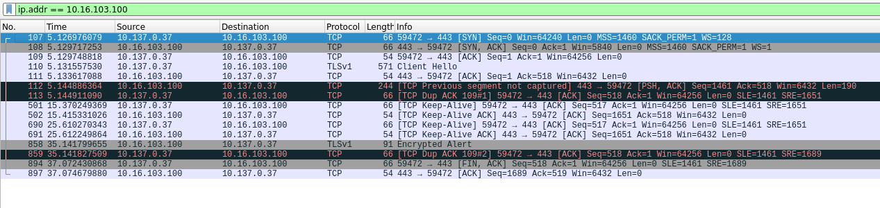

          I also managed to grab a wireshark dump of the connection attempt. Please ignore the differing IP address "10.137.0.37". This is due to me using Qubes OS, an operating system which heavily makes use of virtual machines which automatically receive internal IP addresses. For this issue, you can read 10.137.0.37 == 10.25.102.100.
          Wireshark output showing issue
          The output shows that a TCP handshake is established correctly and the TLS handshake starts as well, but is interrupted immediately. I think that this does not always happen at the same time. When accessing the Google domains I remember seeing a "Server Hello" message.
          If I start a dummy webserver (Linux laptop running Apache) with the same IP address as the VoIP phone I can access the Apache default webpage without any issues, both over plaintext and HTTPS connections. This leads me to the conclusion that this is indeed a bug in pfSense which occurs only together with some particular servers. I don't know how else this could be explained.
