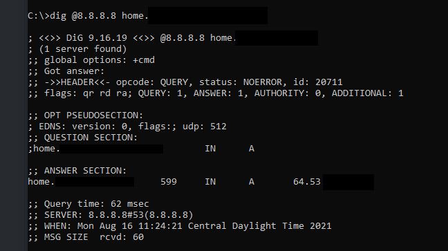

                  I just tried to duplicate this problem - and working fine here..
                  I am running 21.05.1
                  Did a public query for it, and resolving just fine
