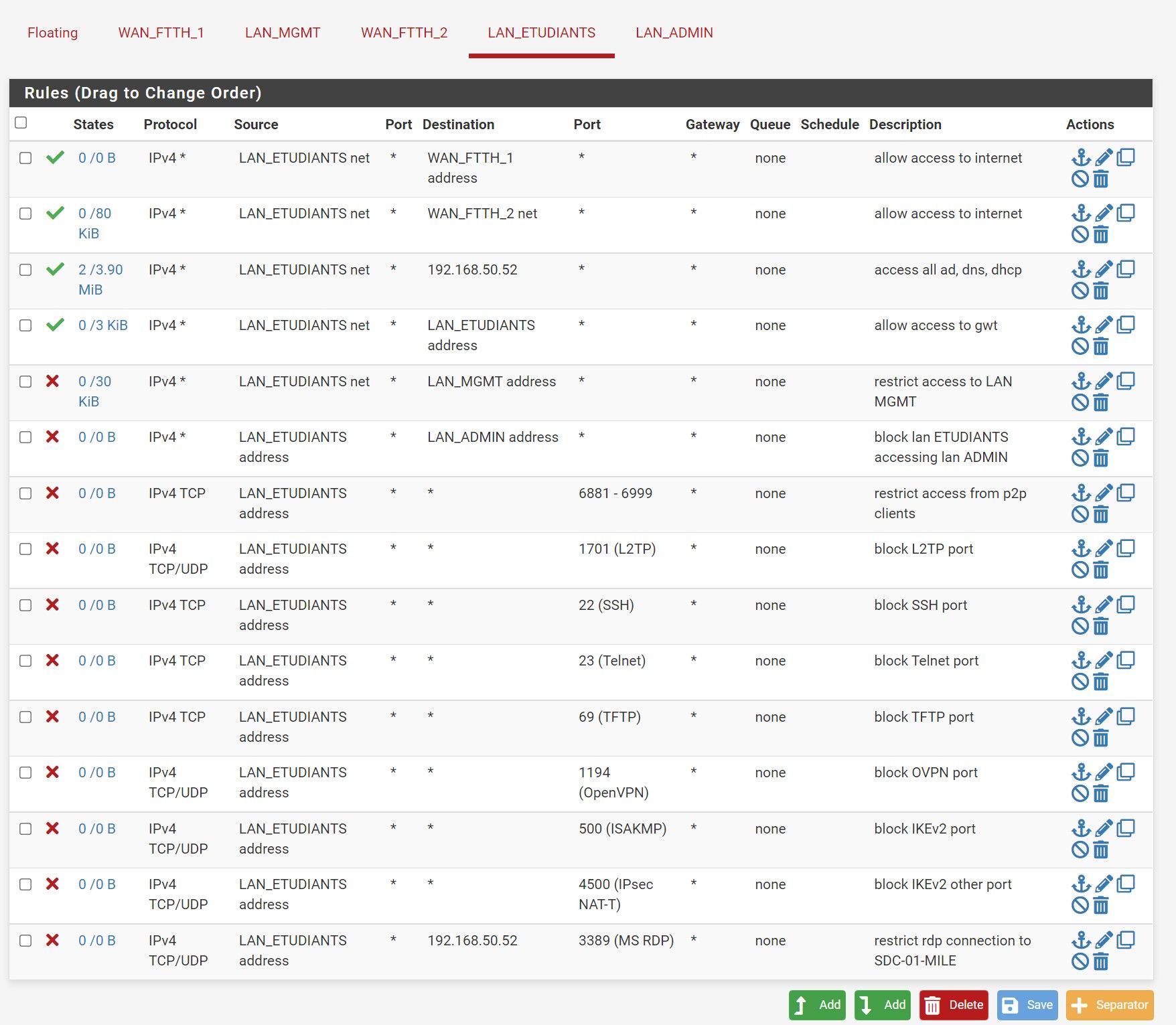

      Hello there,
      I'm guessing someone could help me there. I'm front of a annoying problem. I'll explain you my situation.
      I have two PPPoE WANs:
      WAN_FTTH_1
      WAN_FTTH_2
      Both of us are setting up with a Load Balancer and a Fail Over. I made a gateway group to permute to the more stable one.
      Then, I have 3 LANs:
      LAN_MGMT(pfsense is in that LAN):192.168.50.x - DNS: 192.168.50.52.
      LAN_ADMIN - 192.168.40.x
      LAN_ETU - 192.168.30.x
      I need to set up some rules in the firewall for the LAN_ETU. I need to prevent them from accessing the other LANs. The only thing they can do is to access internet, and the whole LAN_ETU addresses. Which now, I probably messed up something. After days of research, and fails, I can't let this LAN accessing internet. The problem is 100% from the firewall rules but don't know which rule to create in order to let the whole LAN accessing internet. I allowed accessing 192.168.50.52 which is the DNS server.
      If anyone has any ideas to help me resolving this issue. I'm glad to hear your help.
      Here is a screenshot of my firewall conf. Note that if I make a rule with no restrictions it works. The other LANs are accessing internet too.
      awebsterA 1 Reply Last reply Reply Quote 0
      • awebsterA Offline
        awebster @louisleg
        @louisleg The rules you present will not allow LAN_ETUDIANTS access to Internet.
        The rule From LAN_ETUDIANTS net to WAN_FTTH_1 only allows the users on LAN_ETUDIANTS to access the IP of WAN_FTTH_1... I don't think that's what you want.
        You can fix the problem in one of two ways:
        My preference: Create an alias called PRIVATE_IP, and put the networks 10.0.0.0/8, 172.16.0.0/12 and 192.168.0.0/16 in it. Next, insert 2 rules at the bottom:
        From LAN_ETUDIANTS net to PRIVATE_IP - block
        From LAN_ETUDIANTS net to Any - allow
        This will allow access to All Internet, but prevent access to everything internal.
        If you need to allow access to other internal resources, you need to place rules above the 2 rules.
        The second way to make this work is similar, but instead of using aliases
        You would put block rules to each of the other LANs. These 3 rules need to go at the bottom:
        From LAN_ETUDIANTS net to LAN_ADMIN net - block
        From LAN_ETUDIANTS net to LAN_MGMT net - block
        –A.
          johnpoz LAYER 8 Global Moderator @awebster
          As mentioned already about your top rules to FTTH don't allow access to internet.
          Also the bottom rules were your blocking would never be evaluated if your top rules did allow access to internet.
          Rules are evaluated top down, first rule to trigger wins, no other rules are evaluated. So you need to make sure your block rules are above open allow rules (like internet access)..
          Also if your wanting to block access to access to firewall IPs, ie your mgmt rules - the built in alias "this firewall" comes in handy because it includes all pfsense interface IPs.
          Also Your allow rule for ad,dns,dhcp? Is that pfsense IP on Lan_ETUDIANTS net? dhcp doesn't make any sense there since if you enable dhcp on pfsense interface hidden rules are created that make sure dhcp is reachable. if that IP some other network that rule for dhcp doesn't make any sense at all.
          If your wanting to create rules to specific pfsense interface IPs - its better to use the alias for them, which would be the interface name with Address vs Net.

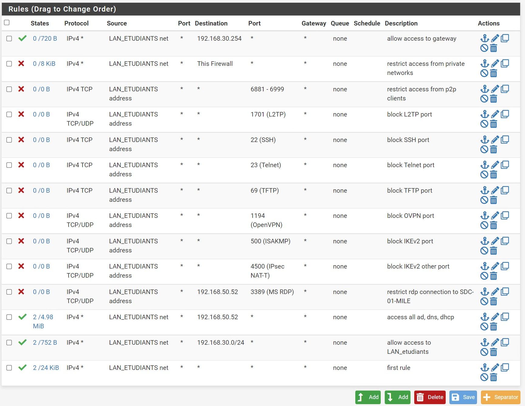

            Thank you both of your for your help. I don't know very much about firewall rules. I'm a beginner. Now everything works, here is the configuration that worked for me. I tried the aliases but in fact the "This firewall" is better I think. Then I allow only things I want. But, last question is it necessary to allow access to the gateway of the LAN I think yes but I'm not plenty sure. Because I ping 8.8.8.8 even if 192.168.30.254 is not reachable by a ping. This is the rule I made to the top. To answer you, all my dhcp, dns services are hosted in a Windows Server 2019 in the MGMT lan.
              SteveITS Rebel Alliance @louisleg
              @louisleg said in Can't ping anything on the internet through LAN:
              No you do not need to allow students access to the gateway. They can talk "through" it without that. It is a good idea to block students from accessing This Firewall or they could try to log in. To be clear though This Firewall is the pfSense itself, not any of its networks. So you haven't blocked access to the other networks, above the rule that allows LAN_ETUDIANTS to * (any).
              Assuming LAN_ETUDIANTS is the 192.168.30.0/24 subnet, those devices don't need a rule as the devices would talk to each other through the switch and not go through the router.

                @steveits Ok, thanks for your helpful informations. I made all the modifications now they can ping each other on the same network but can't ping 192.168.30.254 and access the internet and the dns/dhcp server. Hope it'll be ok now!
