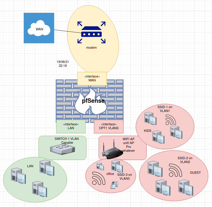

              • noplanN Offline
                noplan @2Cor521
                @2cor521
                looks like something like this
                /me not sure if you're mixin up te term of a wireless Access Point (like a Ubiquiti AcPro) with a
                wireless router like a WRT54G i would go with Access Point
                no you do not want double NAT or router cascade in your network ... more problems and issues
                you will stumble across when u start using the full potential of pfSense
                scheduling per IP
                limiter (up/down) per IP can easy be done by pfsense.
                keep in mind that if you want segregation all your switches must be capable to deal VLAN.
                  johnpoz LAYER 8 Global Moderator @noplan
                  @noplan the one thing I would do differently (if you have the ports available) is connect your AP into your vlan capable switch. You can still use an uplink just for those vlans to another interface on pfsense.
                  But doing so allows you to also put wired devices onto those vlans that your using for wireless.
                  With your drawing, and only 1 vlan on that switch - it doesn't even have to support vlans, only your AP would since it looks to be directly connected into a port on pfsense.
