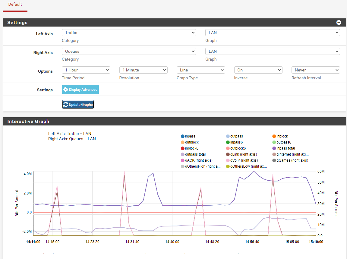

      What I did find while looking through the Status / Monitoring was that the Queues display was showing huge spikes exactly every 15 minutes (see qVoIP in graph below), despite there not being the same level of traffic to back these up.
      I believe the issue might be related to the pfctl invocation, where it is because it is flushing the queues or something because while the freezing occurs there isn't any actual traffic lost, just delayed a lot; I see 4000-5000ms ping times of the LAN interface at the time the problem occurs.

      VMWare performance chat of the pfSense instance, showing CPU spikes

                                    @awebster said in *SOLVED* pfSense freezing for a second or two every 15 minutes:
                                    @stephenw10 said in *SOLVED* pfSense freezing for a second or two every 15 minutes:
                                    The v6 tables can get pretty huge. Check the pfBlocker logs after it updates to see the table sizes.
                                    Yup, I think the smoking gun might be pfB_NAmerica_v6.txt (only USA and Canada selected). If IPv6 list grows much more I can see that it'll be problematic for many people running pfBlocker.
                                    Oddly GeoIP hasn't updated since Aug 5th, but it appears to only update once a month.
                                    I ran /usr/local/bin/php /usr/local/www/pfblockerng/pfblockerng.php dc to force it to update, and the next pfblocker cron run reduced the size of the resulting tables (see 17:00:00 pfblocker update log output below), namely this: Updating: pfB_NAmerica_v6 538 addresses added.97343 addresses deleted.
                                    Sadly, despite the updated DB, the filter reload still causes packet delay/loss. 😭
                                    I disabled any rules referencing pfB_*_v6, but the problem persists.
                                    Question: Does the fact that a rule is disabled still load the tables with pfctl ?
                                    Seems likely that list is causing your problem. Some 600.000 entries is no small amount (and more than one third of the hard limit in pfBlockerNG).
                                    There is the question of hardware as well. If you are trying to do this on fx. A SG-1100/SG-2100 or smaller, you have to remember that the single thread CPU core performance and memory bandwidth of that ARM processor, is less than half of fx. an Intel Atom based box. And the Atom is once again less than half as fast as a common 7th or 8th gen Intel Core CPU. Boxes with that caliber of CPU might not even register loading the same list.
                                    EDIT: Just noticed you are running in a VM on a rather old Intel XEON. The virtualised single thread performance of that CPU is likely struggeling to reach a modern level Atom CPU core. So Hardware may well be part of the problem.
                                    • keyserK Offline
                                      keyser Rebel Alliance @keyser
                                      @keyser Yeah, just looked it up - Its way slower than a modern Atom, even before virtualisation.
                                      So hardware is very likely pressing the issue.
                                        stephenw10 Netgate Administrator @awebster
                                        No, I would not expect it to populate any tables that are not actually in use.
                                        The other table that can be massive is bogons v6. But we have many users loading those on relatively low powered systems.
                                        awebsterA 1 Reply Last reply Reply Quote 0
                                          Not too horrible at 124297 entries.
                                          Some tables as pfctl seems them
                                          -pa-r-- bogonsv6
                                                  Addresses:   124297
                                                  Cleared:     Fri Aug 20 01:07:38 2021
                                                  References:  [ Anchors: 0                  Rules: 1                  ]
                                                  Evaluations: [ NoMatch: 537822             Match: 0                  ]
                                                  In/Block:    [ Packets: 0                  Bytes: 0                  ]
                                                  In/Pass:     [ Packets: 0                  Bytes: 0                  ]
                                                  In/XPass:    [ Packets: 0                  Bytes: 0                  ]
                                                  Out/Block:   [ Packets: 0                  Bytes: 0                  ]
                                                  Out/Pass:    [ Packets: 0                  Bytes: 0                  ]
                                                  Out/XPass:   [ Packets: 0                  Bytes: 0                  ]
                                          -pa---- pfB_NAmerica_v6
                                                  Addresses:   505938
                                                  References:  [ Anchors: 0                  Rules: 0                  ]
                                                  Evaluations: [ NoMatch: 2                  Match: 12                 ]
                                          -pa-r-- pfB_Top_v6
                                                  Addresses:   16341
                                                  References:  [ Anchors: 0                  Rules: 3                  ]
                                                  Evaluations: [ NoMatch: 51426              Match: 150                ]
                                                  In/Block:    [ Packets: 150                Bytes: 10800              ]
                                          –A.
