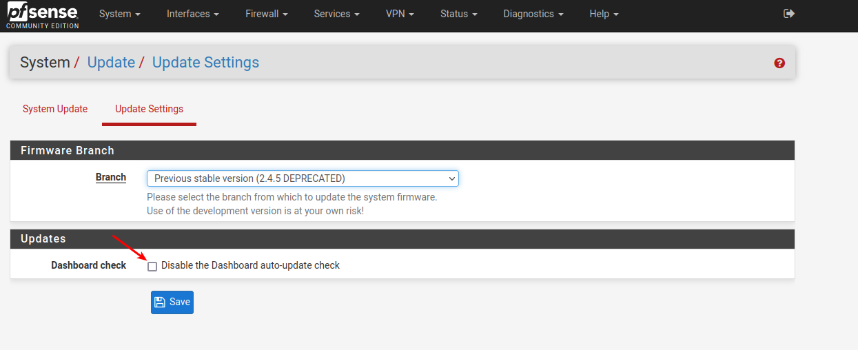

                • bingo600B Offline
                  bingo600 @flarednostril
                  @flarednostril
                  Wasn't this setting a workaround , for the "Gui issue" if was is down ?
                  One of the things the gui does (eagerly) , is to check if there are any updates.
                  And you need a working WAN for that.
                  This one disables that check. I suppose you might loose the automatic update check, if disabling
                  Edit: I have not seen a real timeout here on wan down , just a super slow gui response.

                      • F Offline
                        flarednostril @bingo600
                        @bingo600 Ok I'll test with auto-update check disabled. Thanks for the suggestion.
