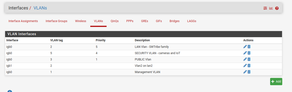

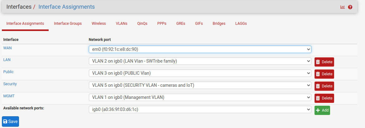

                                      aschmi @stephenw10
                                      @stephenw10 Good you noticed and yes I was using the VLAN2 on igb1 (second interface on a 4 port 1Gbps interface) but not on my normal interfaces
                                      I can send you the whole .XML if you tell me how to sanitize not to send usernames/passwords if that will help
                                        What I have should be enough if the queues were the same.
                                        However you can get the sanitised config as part of the status file by going directly to:
                                        [your firewall IP]/status.php
                                        Nothing special about igb1? igb0 is also a port on the same card?
                                          aschmi @stephenw10
                                          @stephenw10 status_output.tgz
                                          There you have it. Yes igbo, 1, 2 and 3 is just one card (supposedly intel but bought on ebay)
                                          I was trying to use igb1.2 as a bridge with igb0.2, but crashes happened before I started playing with that configuration
                                            OK cool, so you had not added the bridge when it crashed?
