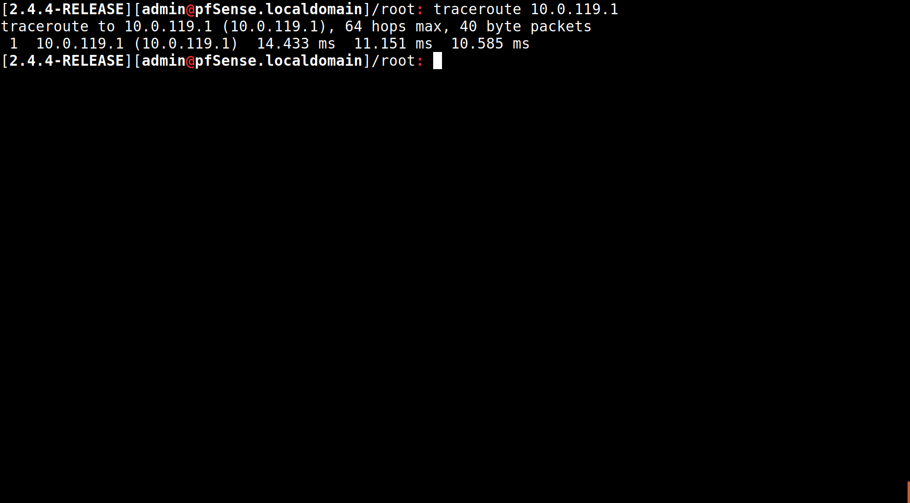

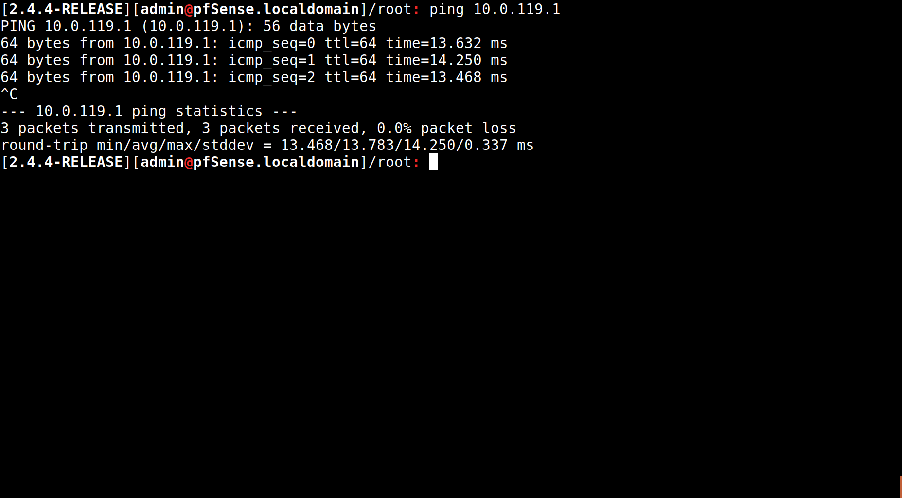

      Hi, I have an OpenVPN server on PfSense and a local LAN of 192.168.48.0/20. And I have an openvpn client (configured with Mikrotik on it) with a remote LAN network 10.0.119.0/24

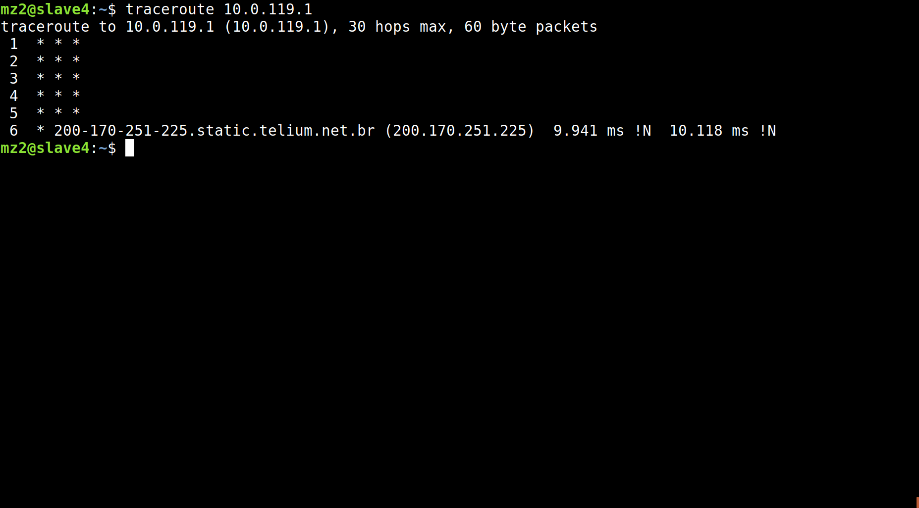

      The connection has been established, and I can connect from my Remote LAN 10.0.119.0/24 > to the 192.168.48.0/20 LAN network successfully, but if I start from any host on the 192.168.48.0/20 LAN (except by Pfsense that this with the 192.168.50.1 network, it cannot ping or any other type of connection.
      See the images below:
      This problem happened after my Dynamic DNS (dyndns) had to change Public IP due to a link drop
      It seems that the hosts behind Pfsense are not able to enforce the remote LAN IP's from OpenVPN.
      Would it be a problem to update internal routes on my LAN that are not leaking?
      And remembering that only one of the clients is working correctly, by showing the letter C marking "An IP address followed by C indicates a host currently connected through the VPN."
