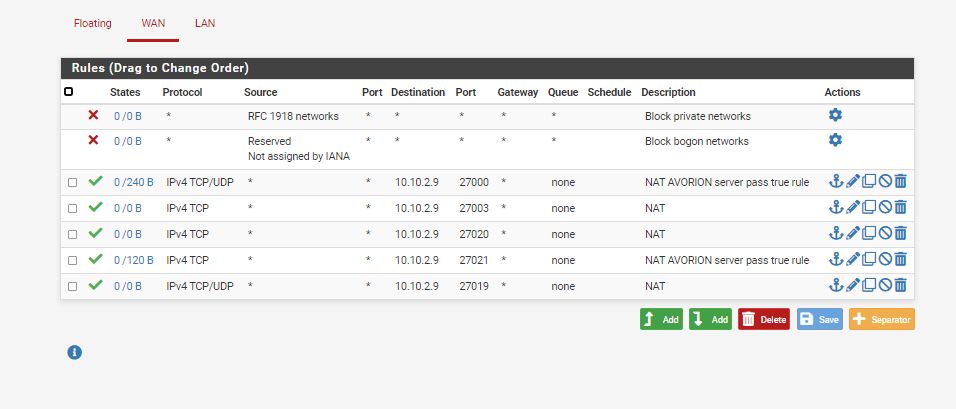

      i like to host this game avorion but the router seems to block all the communication to the outside. i have all ports needed forewarded (27000,27003,27020,27021) via the NAT rules and are linked to the FW rules

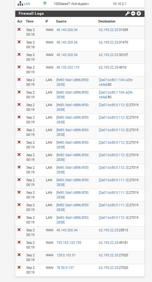

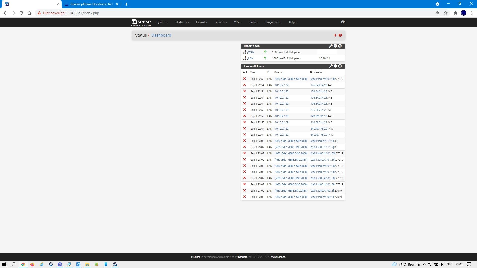

      still i cant see the server from the outside and my dashbord shows the following:Naamloos.jpg
        And 10.10.2.122 is the game server?
        That traffic should passed by the default firewall rules on LAN unless it's out of state TCP traffic.
        Can we see the full firewall logs, not the reduced version in the dashboard widget.

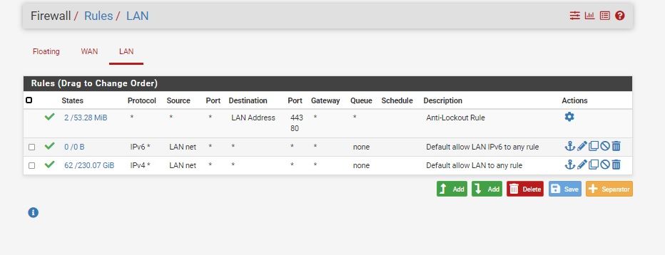

        And the LAN firewall rules.

              stephenw10 Netgate Administrator @stephenw10
              @stephenw10 said in game server connection issue:
              So, no, it's 10.10.2.9?
              We need the full logs from Status > System Logs > Firewall
              The LAN rules are allowing everything so those blocked packets are probably just FIN-ACK or RST-ACK.
              https://docs.netgate.com/pfsense/en/latest/troubleshooting/log-filter-blocked.html#troubleshooting-blocked-log-entries-for-legitimate-connection-packets

                  If those port forwards are correct I would expect it to work. I note though that the rules on WAN to pass traffic to them show 0 states and almost no traffic. It looks like nothing has tried to connect.

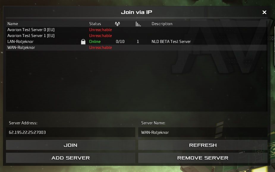

                        i start the game server from console on the ubuntu server PC via VNC on my laptop then i go to steam and see if the server is online on the steam list and direct-IP list there it shows on the LAN part but not on the external list.Naamloos6.jpg

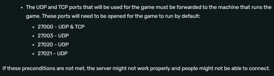

                          @pahtriac According to the wiki, at least one contributing factor appears to be misconfigured port forwards:
                          Ports 27003, 27020, and 27021 should be forwarded with UDP.

                            Are you testing from a game client behind pfSense and trying to use the external IP?
                            That's not a good test if so and isn't expected to work by default. That would explain why the rules showed zero states.
                            You should test from a remote public IP. If you really need that to work internally though you can enable NAT reflection:
                            https://docs.netgate.com/pfsense/en/latest/recipes/port-forwards-from-local-networks.html
                            But you should not need that and you should be aware that it's not actually testing the port forward.

                              @marvosa good that you saw that that was to see if it would have worked with tcp and forgot to put them back to udp.
                              i can show you that even with the correct protocols it still does not work. :(

                                @stephenw10 i can see this aswell by browsing tru the steam server lists. it is not showing there where it did when i was using my ISP modem/router aswell the WAN side of the game client direct IP connection was showing green then.

                                    Do you see states/traffic on the port forward WAN firewall rules when you try to connect?
                                    Or you can enable logging on those rules connections using them will show in the firewall log as passed.
