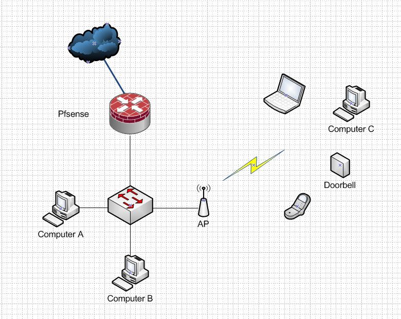

                            And how do you have this all wired up?
                            Pfsense lan into this dumb 24 port switch, then your AP connected to the switch. Do you have other wired devices, have to assume so or why would you have a 24 port switch? Can they talk to each other?
                            example
                            What specifically can not talk? Can computer A talk to B, can C talk to A.. Can devices like laptops or phones talk to anything on the wire, or other wireless devices?
                            If it was pfsense issue - then A could talk to B for example. But A or B or C couldn't talk to pfsense but could talk to each other.
                            Pfsense IP is what exactly? 192.168.1.1? What is the IP of this doorbell when it comes online? You sure its just not the doorbell with same IP as pfsense lan?
                            Does say computer A, show the mac address of pfsense or computer B, C ?
                            It just really seems unlikely that 1 device could take out a whole network.. Even if was spewing nothing but garbage.. And loads of it.. It shouldn't be able to stop A from talking to B..

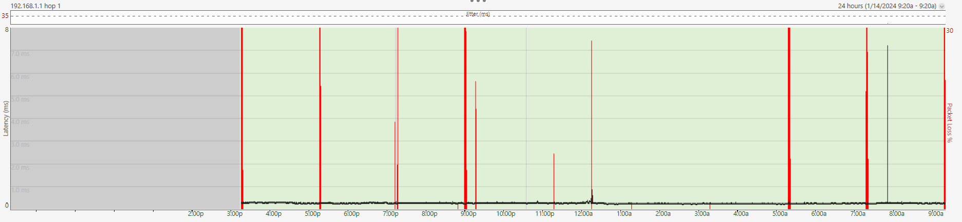

                                        Did you ever solve this? My LAN is also choking randomly every few hours - pfSense LAN interface becomes unresponsive. WAN works fine, no errors in my logs either.

                                            It is very odd - I've be struggling with this for the past few weeks:
                                            • LAN interface becomes unresponsive and drops packets
                                            • Console remains functional and I can ping to WAN (next time I'm going to run to the console to ping LAN as well)
                                            • I can ping other LAN devices from my PC - no dropped packets, so I have isolated the issue to pfSense
                                            • Smart Netgear Switch reports no errors
                                            • No obvious errors in logs or dmesg, closest perhaps is unbound has a HUP exit and restart
                                            • System recovers after 1-2 minutes but that is enough to interrupt streams
                                            • Ran memtest86 no issues
                                            • Swapped three different NICs and ports
                                            • Swapped CAT6 cables
                                            • Swapped Network ports and Switch
                                            • Did a reinstall of CE and still see the issue albeit much less frequently
                                            • System has Intel I219 and I225-LM NICs - it used to be virtualized and ran solid for years. My issues seem to have cropped up when I reverted to baremetal
                                            Nothing is logged in pfSense which I find very odd.
                                            As a side note, is there a way to get timestamps from dmesg?
