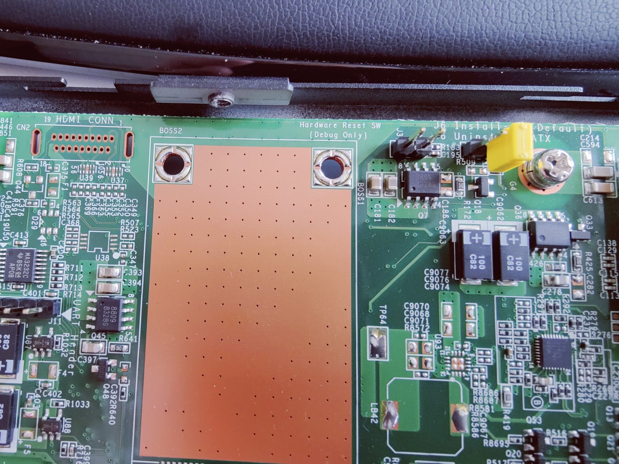

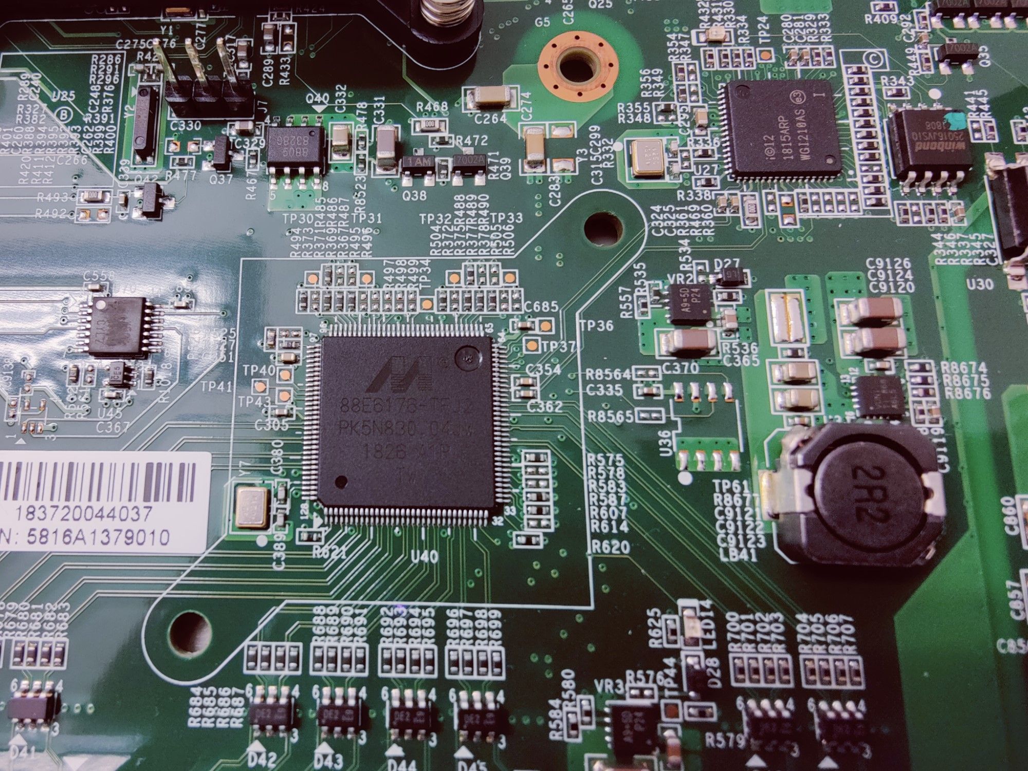

      First some pictures of the board:
      IMG_20210912_112552 (Benutzerdefiniert).jpg IMG_20210908_110628 (Benutzerdefiniert).jpg IMG_20210911_180131 (Benutzerdefiniert).jpg
      The board has 5 switch ports which also seem to be driven by a Marvell 88E6176-TFJ2 switch chip. Differences to the T70 is the lack of DIP Switches for the internal Marvell switch chip. Besides that the PCB around the Marvell chips looks quite identical to the T70.

            Did you remove a heatsink from the switch IC?
            • P Offline
              perrin @stephenw10
              @stephenw10 said in Watchguard Firebox T55:
              Yes, i did. See picture #3 in the first post. The switch ic is the same as in the T70 (Marvell 88E6176), but it seems that the eeprom is not connected (U36 is empty), also it is missing the DIP switches. I can take more pictures of the PCB is necessary...
