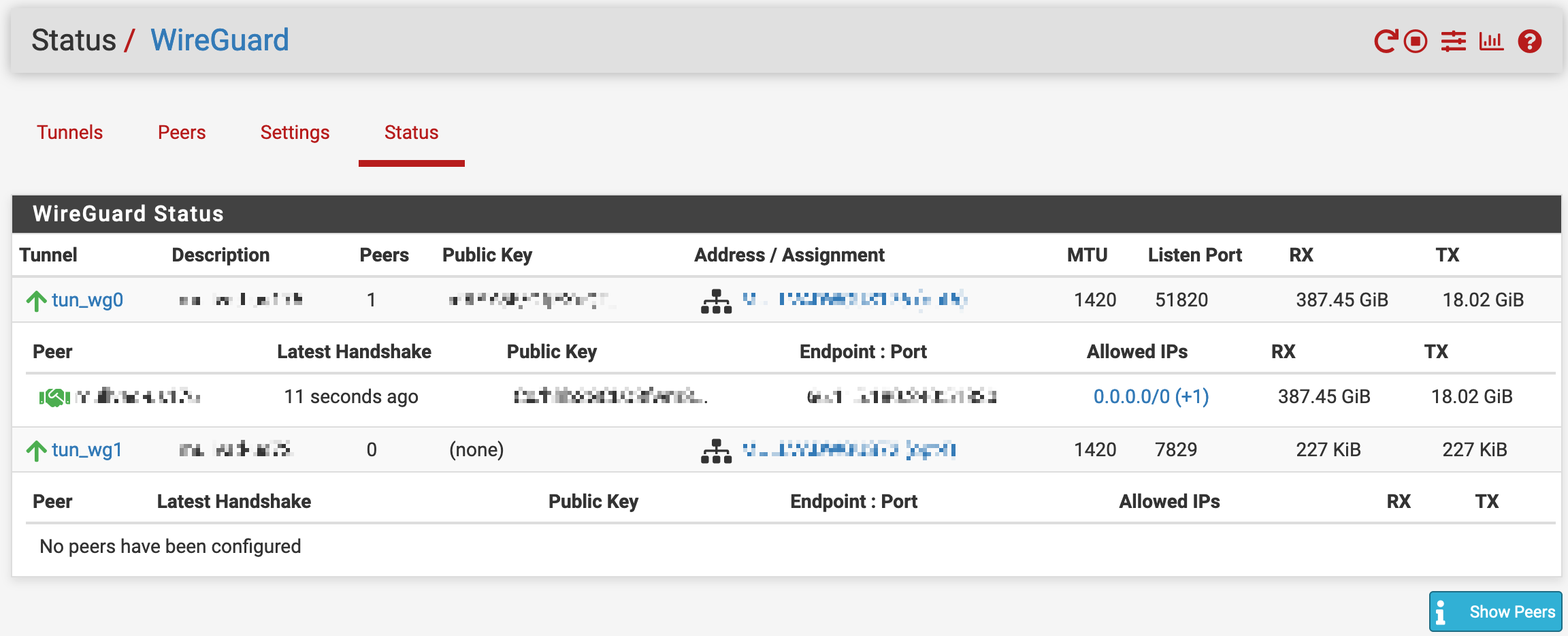

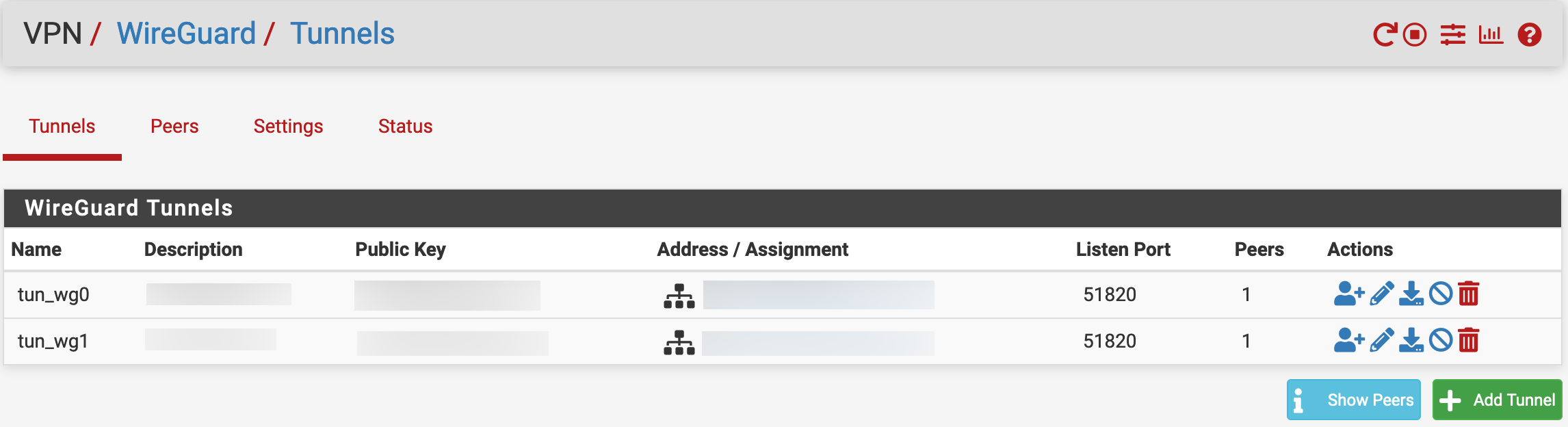

      One of my Wireguard tunnels works, the other shows no peer on the status tab and different listen port than on tunnels tab. What is wrong?
      Tunnel setup shows that both tunnels have a peer, and a listen port.
      On the status tab, only the first tunnel handshakes, while the second one indicates there are no peers configures and has a totally different Listen Port displayed.
        cubeyglyph @cubeyglyph
        @cubeyglyph For what it is worth I realized my error. I configured the listen port on the firewall the same for both peers, I did not realize that each peer needed a unique port to listen on, I thought it would still route properly. Once I changed the peer listen port to tow unique values both peers came up just fine.
