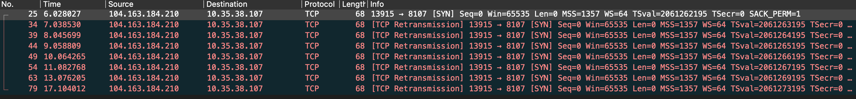

      When it doesn't work, this is the packet capture file opened in wireshark, so there are retransmissions

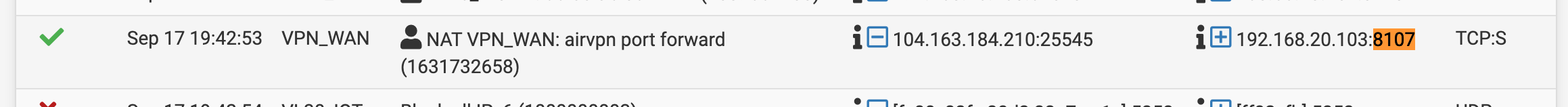

      I can see on the firewall logs, that the NAT port forward rule is being logged, so it's working

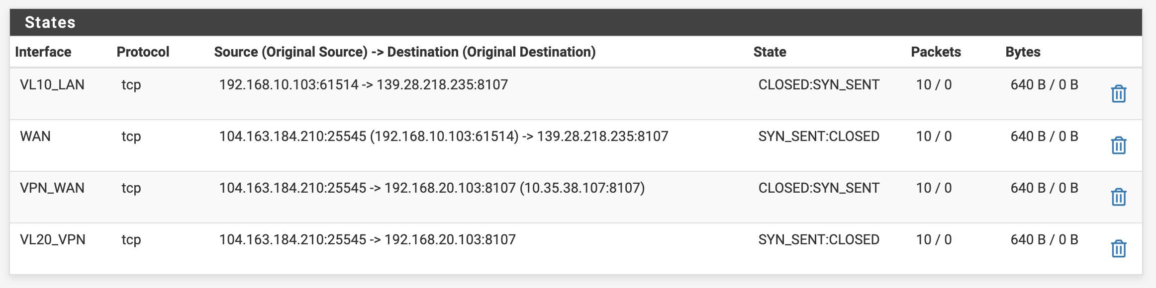

      On the states this is what I see for the port 8107
      And just in case this is the CAP file during the small test
      timeout.cap

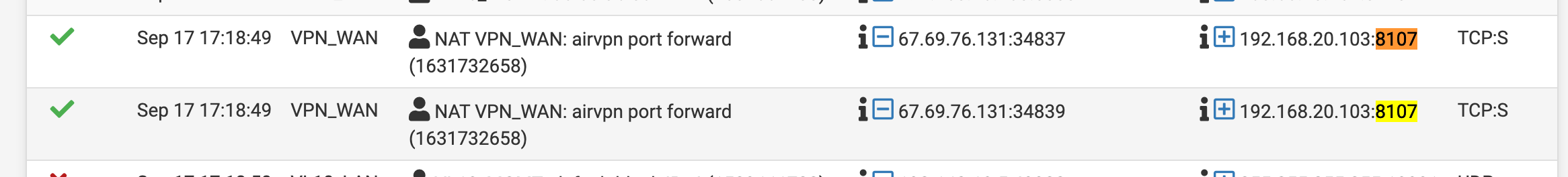

      Now when it works, using the phone with the phone network (no home wifi)

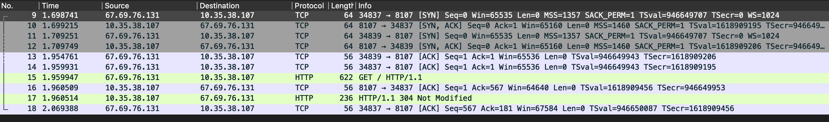

      The packet capture file opened in wireshark, so we can even see the HTTP protocol request and response
      The firewall rule get logged
      The states look different when working
      And the capture file when working
      working.cap
