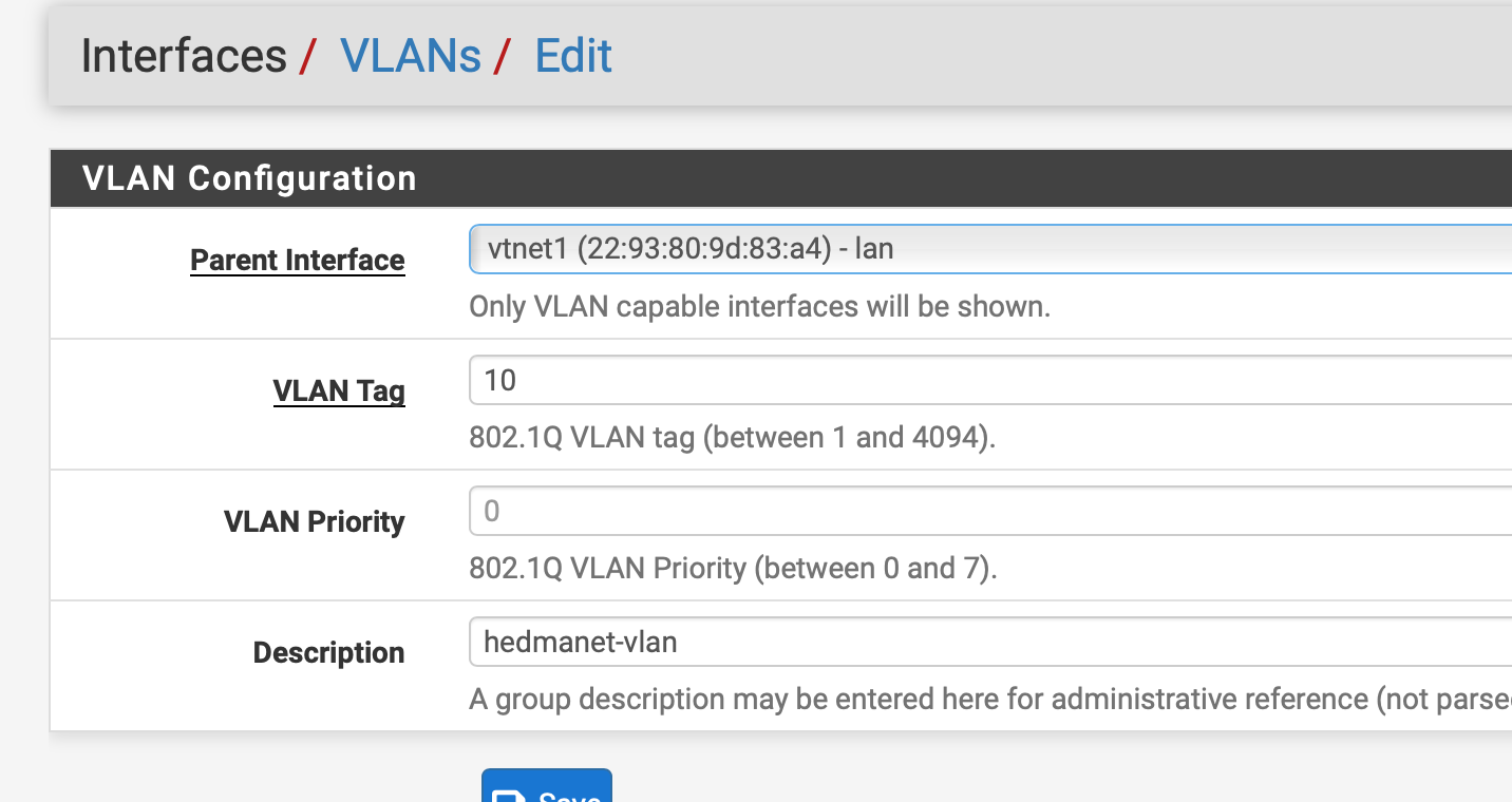

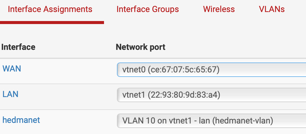

      So I did remove all the vlans and assigments.

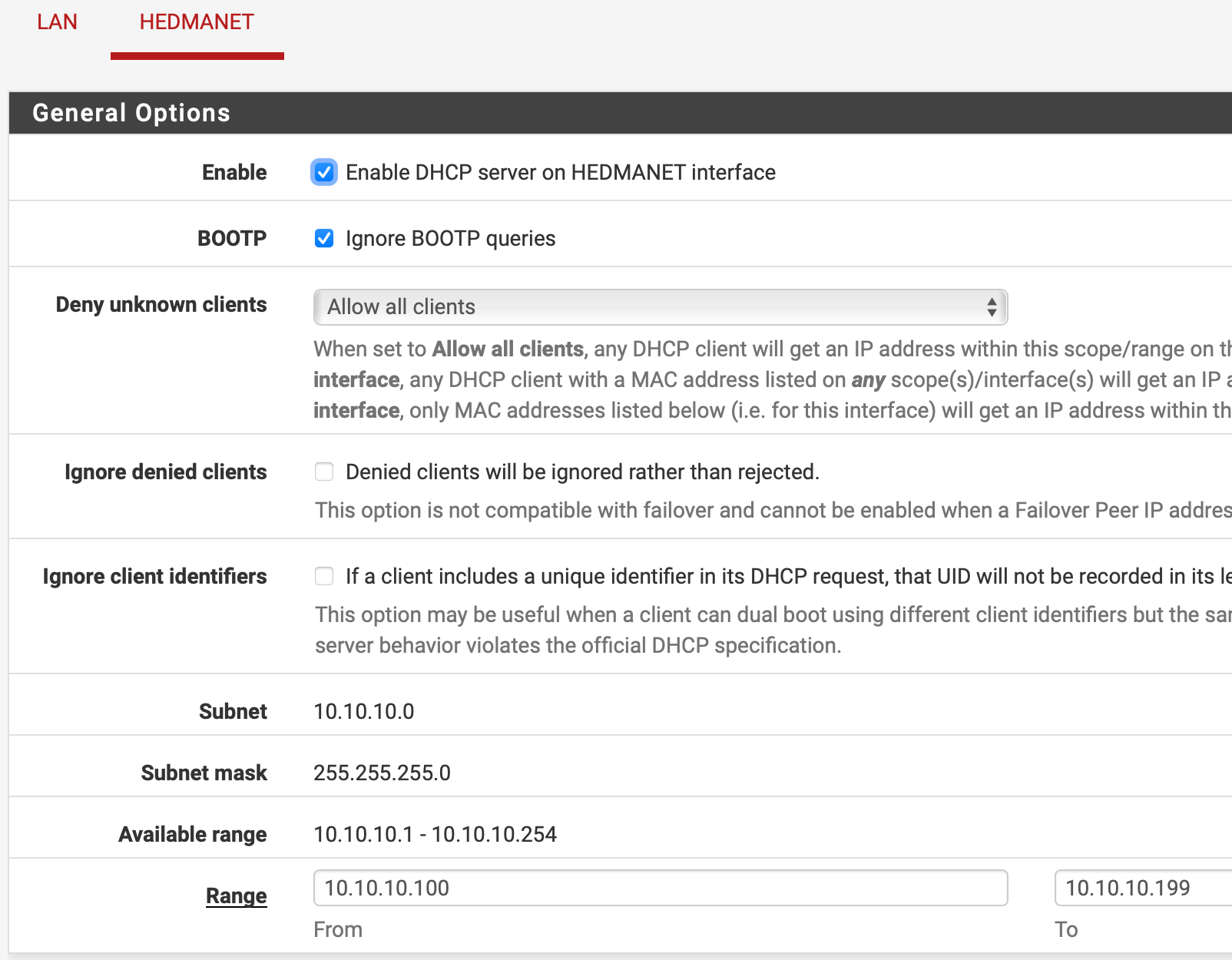

      Remade the vlan, assigned it, created the dhcp server.
      Started a VM with Ubuntu to connect to vlan 10, the VM can not connect to the network.
      This is my issue, the clients cannot connect to vlan network. On the dashboard Traffic graph there no activity on the vlan.
      What is missing? Firewall rules? Gateway? Please help. :)
