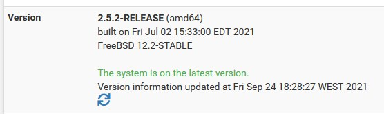

        Watch this, pls.:
        So, for me, NordVPN works perfectly with all versions of pfS ๐Ÿ˜‰

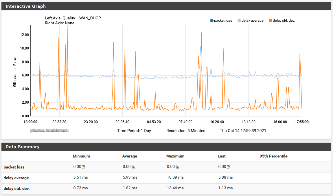

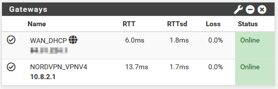

                  @daddygo Here some graphs/data from both 2.5.2 and 2.4.5. When comparing the graphs/data, I get the impression that 2.4.5 is having more packet loss than 2.5.2. Though I am experiencing the issues with 2.5.2...
                  2.5.2
                  2.4.5
                  So these graphs/data do not point me into a direction as where the cause could be. Or am I overlooking something?

                    @meridium said in Degraded OpenVPN connectivity to NordVPN after upgrade 2.4.5 to 2.5.2:
                    Sorry for my late.... :)
                    Yes, :-)
                    These measurements may not be relevant because they vary from moment to moment. (ISP load, the neighbour's dog, etc.)
                    Other people would be very happy with your results (6 / 14 ms and 7.5 / 15.4), so let it go, because everything is perfect.

                      I think my last response got interpret in a way I did not intended it to.
                      My last email with the graphs/data, was not about showing how the numbers support my experience that 2.5.2 in my situation has degraded OpenVPN connectivity. But was in response to your email on September 24th. In that email you showed your graphs/data and stated that OpenVPN works just fine for you on 2.5.2. The intention of my last email with the graphs/data, was exactly to demonstrate that these graphs/data do not show what I am experiencing in OpenVPN degradation and therefore not helpful in investigating my issue with OpenVPN. Indeed when looking at the graphs/data for 2.4.5 and 2.5.2 and comparing them, there is little difference and one could think there is no issue. However, I still am having an issue with OpenVPN on 2.5.2.
                      That is why I ended my last response with 'So these graphs/data do not point me into a direction as where the cause could be. Or am I overlooking something?'.
                      So if you have other suggestions as in how to investigate, please share your thoughts on this.
