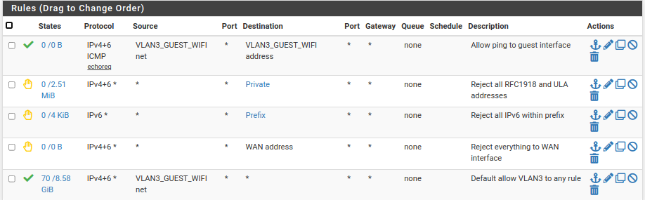

        Perhaps you should only connect to your guest network and have your rules set up to not allow anything to the main network. That's what I do here. I have my work computer connected to my guest WiFi and my rules do not allow any access to my main network or even pfsense, other than ping the interface.
        Here are my guest WiFi rules:

              @gwaitsi
              I use block IPv4 & IPv6 because I have both on my network and am just covering all bases.
              As for your connection, a guest LAN, such as mine, should be all you need and you could still have other guests on it. As I mentioned, my work computer is on my guest VLAN, so they could probe all they want and won't find anything. I have OpenVPN on my main network.
              BTW, I was just looking at some stuff from my work computer. I'm currently doing training for Avaya IP Office unified communications and so was using Packet Capture to see what it was doing. Likewise, you could use it to see what snooping is going on.

                @gwaitsi said in Backdoor into Home network through company laptop:
                why do you have the block ipv4+6 at the top? I have;
                allow IP4 work_laptop port 443 to work_vpn * gw_wan
                reject IP4/6 * * * *
                do i have the order wrong?
                As mentioned above, rules are run in order until first match. So, I first allowed ping to the interface. I then blocked the specific IPv4 and IPv6 addresses and finally allowed access out to the Internet.
