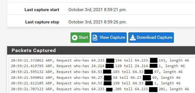

                              As to sniffing - on pfsense, do a packet capture on your opt interface you were using for wireless. In promiscuous mode.. set it for just arp on the protocol
                              Do you see arp traffic from the internet? For example.. This is my actual wan interface - I tried to run some wireless network here it would be directly connected to the internet no matter what "ip" Layer 3 range I ran on it..
                              This interface is connected to the internet.. Running some AP on your isp device that you put into bridge mode and tried to run wireless on - "could" very well just be bridging that wifi to the internet.. Be it you running as some rfc1918 network or not.
                              That sniff ran for 5 seconds - that is just small portion of what it saw, none of those IPs are my pfsense wan IP.. Those are just other isp clients on the same L2 as my wan.
