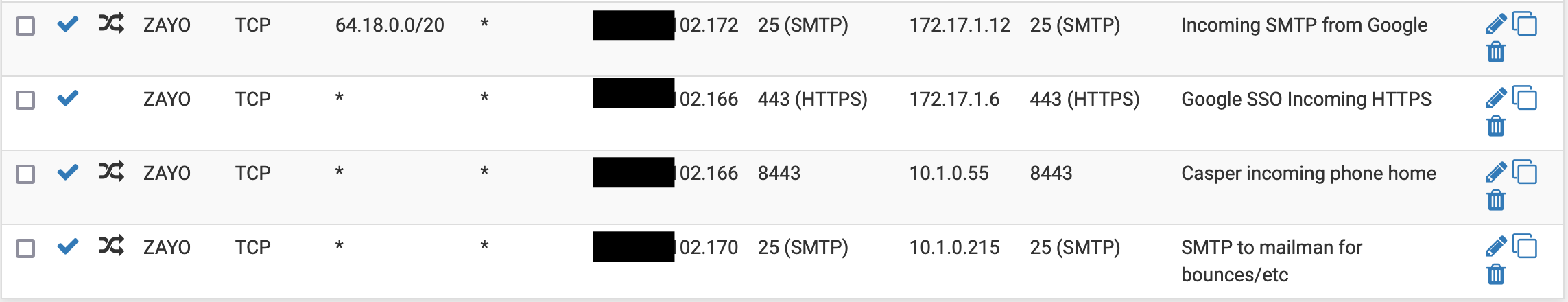

Here are the 1:1 NAT rules with the public IP redacted.

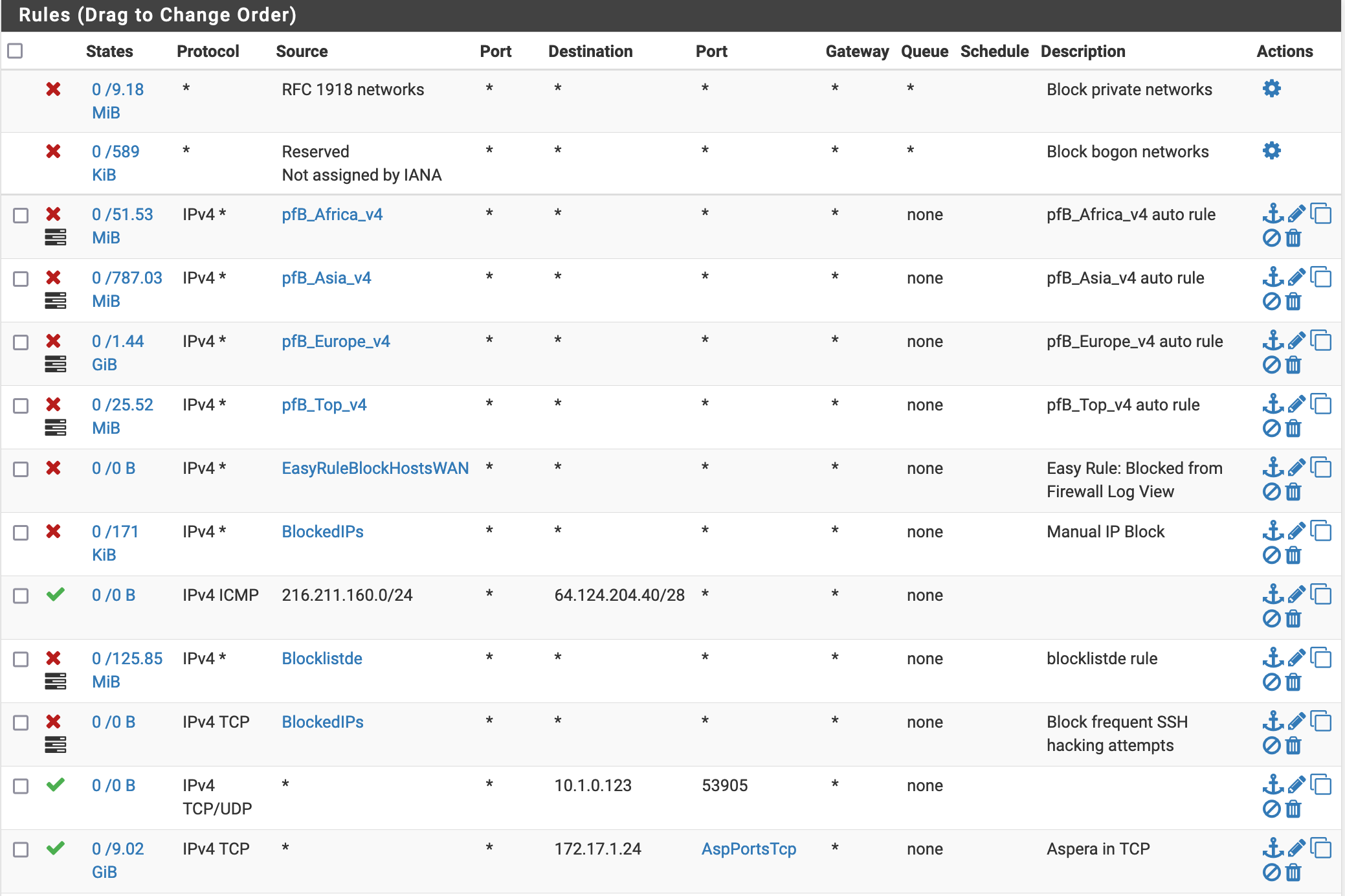

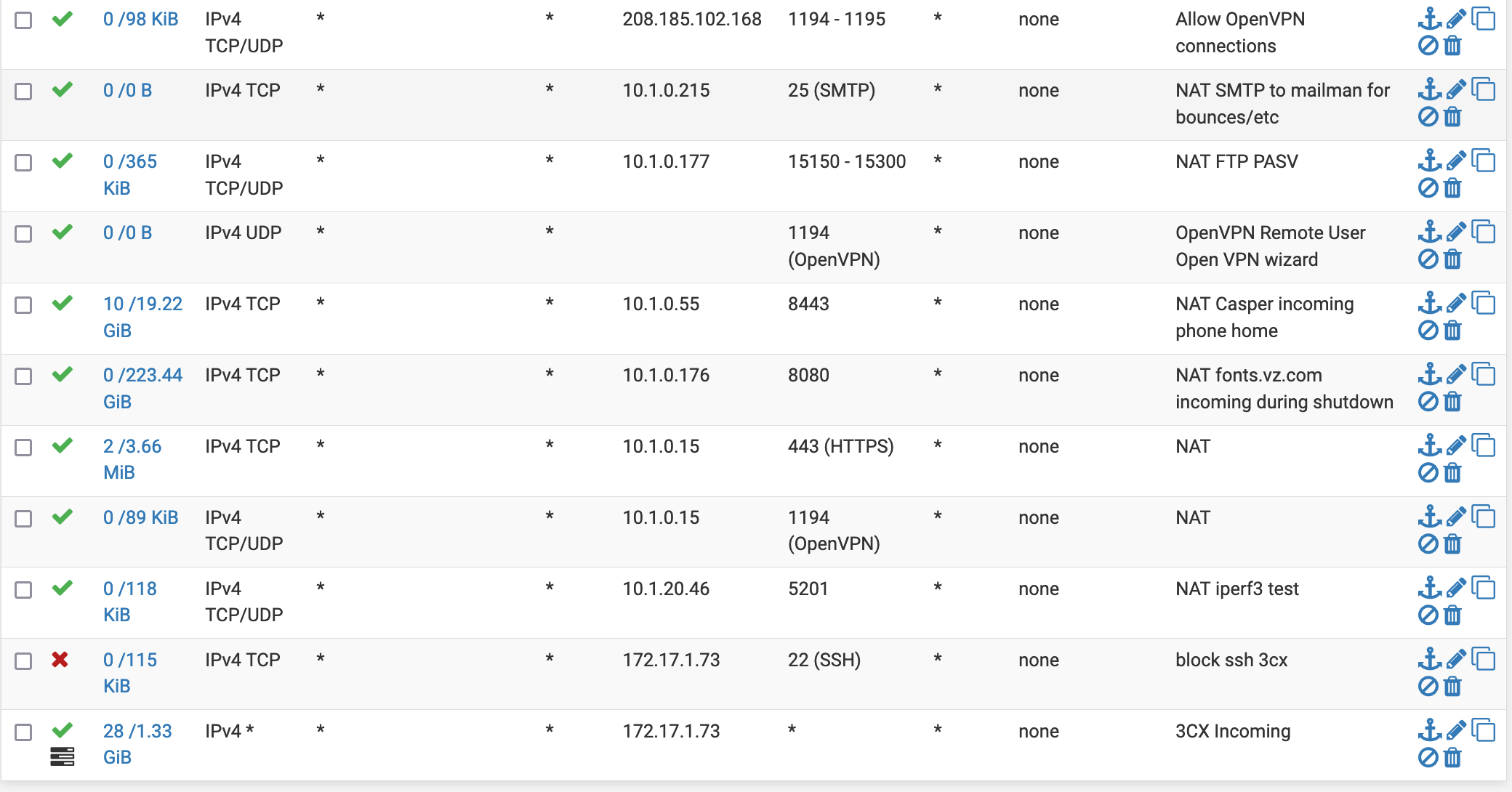

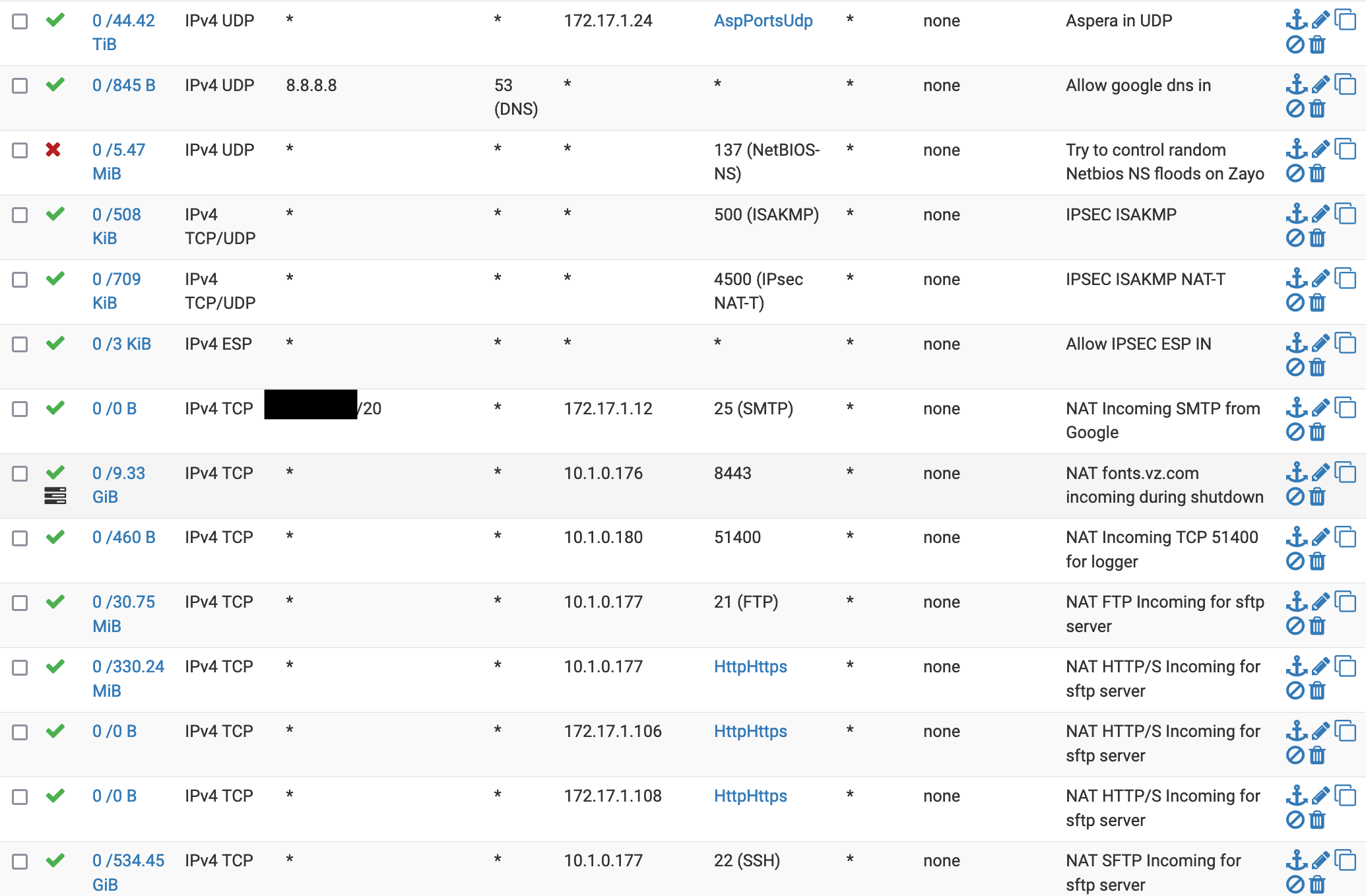

login-to-viewHere are all of the firewall rules on that same "ZAYO" Interface with minimal redaction:
login-to-view
login-to-view
login-to-viewIf there's a better way to get this to you than screenshots, let me know.

@scottcall that is much easier to read.. ;)
But you have a lot of block rules, where are you showing that its the default deny rule.. Turn rule names in your firewall log so you can see which rule is actually blocking. You have a lot of block rules above that don't even log, etc.
From your rules, clearly you have some that are not 1:1 nat - so what are the other port forwarding rules?

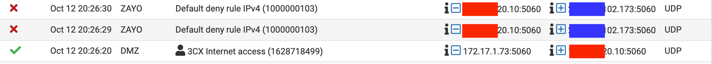

Here is the log snippet that shows the packets from the SIP provider being blocked by "Default deny rule IPv4" with the external IP showed as the destination (since it did not get 1:1 NAT) but then 10 seconds later I send random UDP from my home network to the same external IP (also using same source and dest port) and it makes it through.
As you said there are other (port forwarding) incoming NAT setup, but none of them have either the source, external destination or internal destination listed. Here they are for good measure:

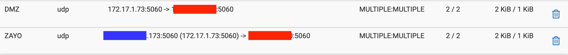

Grasping at straws I was wondering if the state created by the 3CX registering with the provider was an issue since it contained the same IP and port info as the incoming connection? (Blue is my public address, Red is the SIP provider's)
login-to-view
login-to-viewJust for grins, I changed the trunk time at both ends to be IP based (no authentication) just to see if anything changed.
For reasons I cannot comprehend, it started working.
SAME source address, SAME destination address, but it's being properly NAT'd now.
I literally have no idea why that worked when the other way (registration based) didn't?
So I guess everything is okay now but I really really hate problems that don't make any sense and the resolution just feels like pushing off the inevitable when it breaks again.
