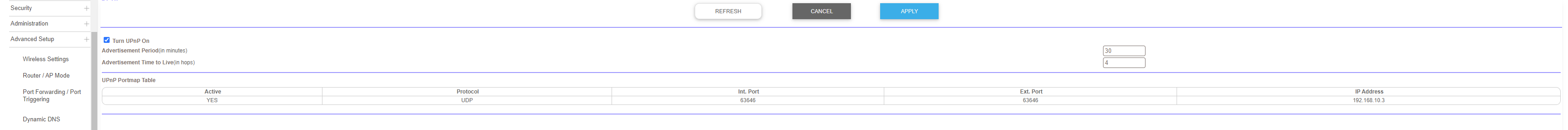

      I have attached a screenshot from my previous setup where I had 0 issues turning on uPnP. Any way I could make uPnP work as expected with out doing any NAT rules ?

          Thanks Stephen for your reply. Just to give you a better under standing I have attached 2 files. old setup and new setup. Also please note I don't have much control over the fiber gateway. A restriction from the ISP. I also can't just move the fiber connection to PFSENSE WAN port as the configuration of the fiber gateway is only accessible from the ISP and it is not shared with end users.
          Old Setup:
          As you can see from the drawing, RBR50 WAN ports connects to one of the Fiber gateway LAN ports and gets an IP from 192.168.100.0 / 24. And RBR50 was acting as Router / DHCP for LAN and devices gets and IP Address from 192.168.10.0 / 24. So any traffic leaving LAN will get NAT-ed to the WAN port of RBR50 , then gets NAT-ed again to the public IP address of the fiber gateway. So double NAT-ing was already working in the old setup and uPnP was working fine without any problems.
          New Setup:
          It's slightly similar to the old setup but PFSENSE came between the fiber gateway and RBR50. In this setup , RBR50 is running in bridged mode. and PFSENSE is doing all the routing / DHCP, etc. However uPnP does not work. The only way to make games work on consoles or PC properly is do an outbound NAT.
          So I take it from the link you shared, that uPnP will not work in this setup ? However it was working perfectly fine in the previous setup. and it was a double NAT setup as well.
          Old Setup:
          New Setup:
