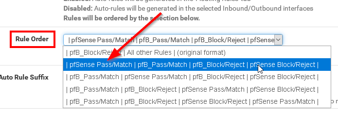

      I installed an addon pfBlockerNG. It works fine. However, I have a few addresses I need to exclude from being blocked so I created a whitelist (alias) and placed the rule ahead of pfBlocker rules. This works fine until pfBlocker cron-updates itself every hour and moves its rules over the top of my manual whitelist. How can I make my rule stay where I want it?
      V SteveITSS 2 Replies Last reply Reply Quote 0
      • V Offline
        viragomann @peterlecki
        @peterlecki
        Change the rule order in pfBlockerNG.
        P 1 Reply Last reply Reply Quote 1
