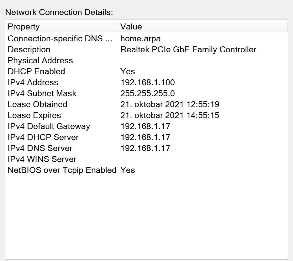

            • N Offline
              nimrod @Gertjan
              @gertjan
              This is the DHCP status after i reboot my Linux machine, and go to Windows. As you can see DHCP assigns everything as it should, but there is no connection to internet or pfSense box. These assigned parameters are 100% indentical to the parameters that get assigned after i reboot my pfSense box. The only difference is, i have internet connection and i can access my pfSense box via web gui.
              For the sake of this thread, i have cleaned DHCP log and repeted the whole process of rebooting the PC and then pfSense box. This is the fresh DHCP log:
              dhcp_log.txt
              I have "masked" MAC address.
