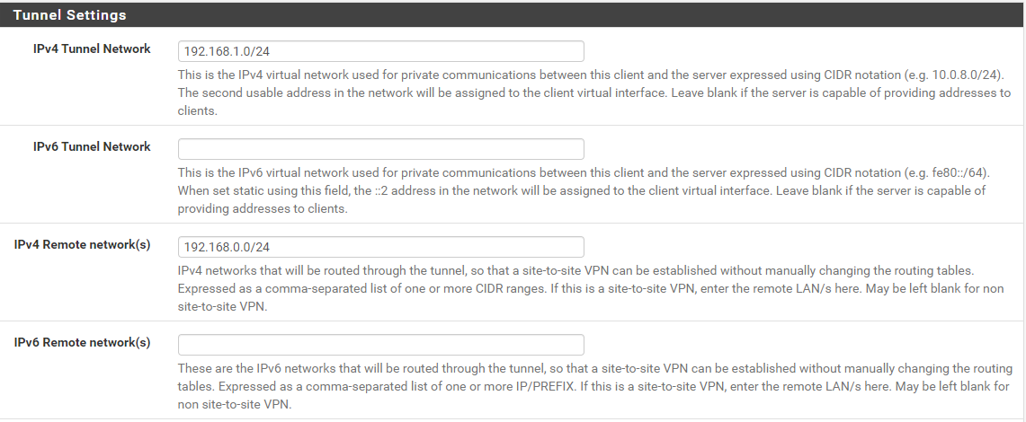

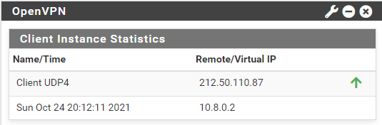

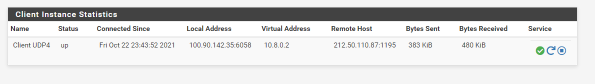

      I connected to my OpenVPN server at home with this tunnel settings
      and as you can see I can the ovpn interface goes up fine

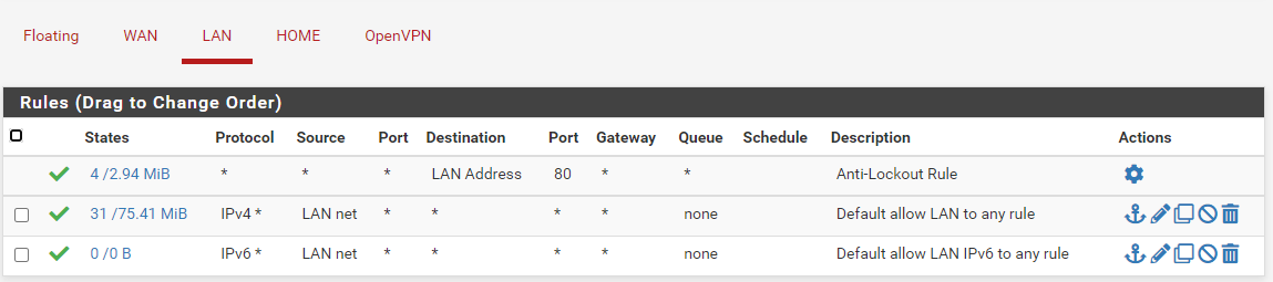

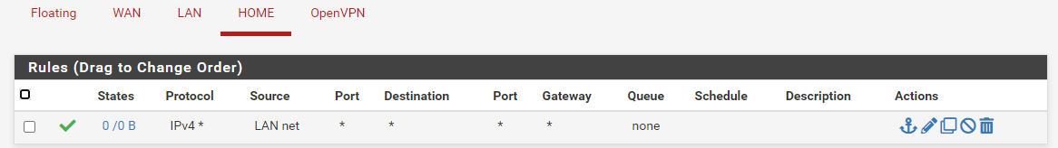

      then I made a rule on my interface to allow traffic
      LAN should be fine since I have the default allow any rule
        Leave the Tunnel Network box blank. This is given by the server.
        The rule on HOME might be useless with LAN net as source.
        Anyway a pass rule here is only for allowing access from the remote site to you.
        Also check the rules on the OpenVPN tab. These will also by applied if they are matching.

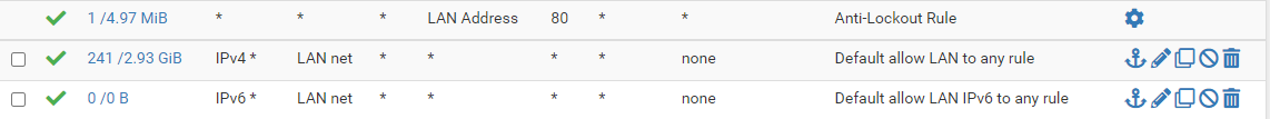

          changed
          LAN
          HOME
          OPENVPN
          Are you able to access the OpenVPN server by its virtual IP? This requires that there is a network service running on of course.
          yea

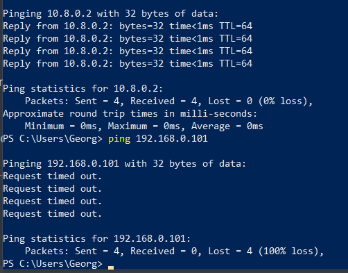

              from pfsense shell its fine
              from my laptop that is on the LAN it doesn't work
              so I guess my static route works
              is it something with the firewall?

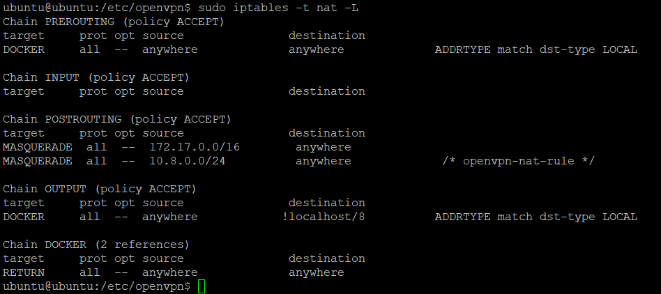

                It might be a routing issue. But you can also solve it with masqerading as I already mentioned above. I'm assuming that the Ubuntu server is not the default gateway in the home LAN and the devices do not have a route for the tunnel network to the server.
                So since you're able to access the remote devices from pfSense the Ubuntu server might have a masquerading rule in iptables for the packets from VPN clients (subnet 10.8.0.0/24) on its LAN interface.
                Now you need also such a rule for your LAN 192.168.1.0/24.
                Alternatively you can add an outbound NAT rule on the Home interface on pfSense and hence do double NAT.

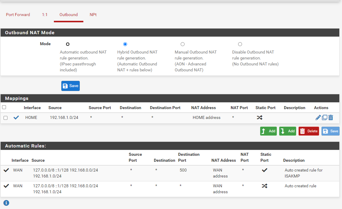

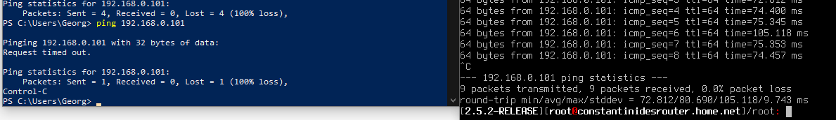

                  yes you are right the ubuntu server is not the default gateway
                  I added the outbound rule and now i can have access to my home lan from my lan

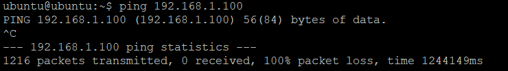

                  from my laptop on my lan pinging the ubuntu server and my default gateway (isp router)
                  but my home lan still doesn't have access to my local lan
                  I guess I have access because when I sent a packet and the device on my home lan replies it replies to the ubuntu ovpn server and the server sends the packet thru the tunnel but when a device from my lan tries to communicate it sends the packet to the default gateway and the default gateway my isp router doesn't know what to do with it. correct?
                  found the masquerading rule on the ubuntu server. do I have to add another one with source 192.168.0.0/24 and dest 192.168.1.0/24 to work?
                  btw I appreciate all your help thus far. i am starting to understand how this works now.

                    As I mentioned with the additional outbound NAT rule you do NAT (masquerading) twice on packets from your LAN to home LAN. Once on your pfSense when packets are going into the VPN interface (packets get 10.8.0.2 as source) and a second time on the Ubuntu when packets are going out to the home LAN (packets get the home LAN IP of Ubuntu).
                    You didn't mention before that this is also desired, even if I asked for it.
                    This is more complicated, since the VPN endpoint is not the default gateway in the home LAN.
                    I assume the home LAN router is not capable to manage multiple network segments. If that's true you will need a static route for your LAN pointing to the Ubuntu server on each device which you want to have access to your LAN.
                      dlogan @elliopitas
                        dlogan @viragomann
