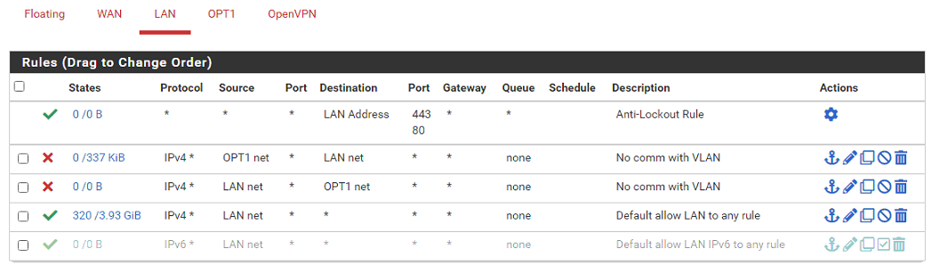

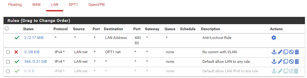

      Traffic from LAN to OPT1 blocked
      Traffic from OPT1 to LAN blocked

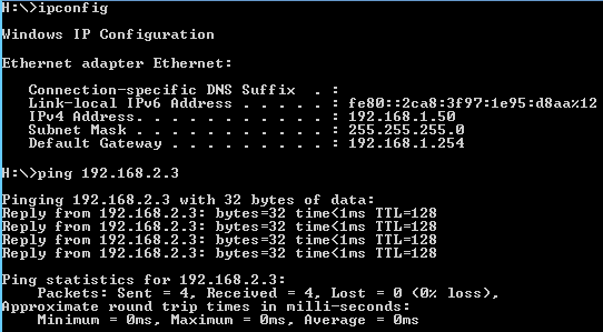

      But yet I can ping from a host on LAN to a host on OPT1 and it returns.
      What am I missing?

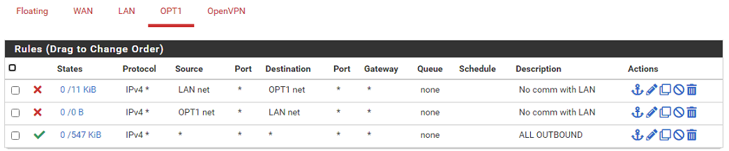

                    • P Offline
                      peterlecki @mer
                      @mer
                      Even though I'm not at all understanding how the LAN interface should have a OPT1net as incoming source, I made it both ways, but as I expected, it made no difference.
                      On the LAN interface there is a default rule to "allow LAN to any" - I didn't create this, it was automatically made during initial setup. As you can see the source is LANnet which is how I made the rule to block traffic to OPT1net. Hence my confusion about your comment to use OPT1net as the source.

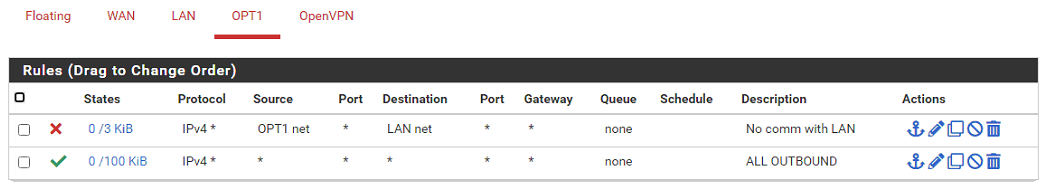

                            johnpoz LAYER 8 Global Moderator @SteveITS
                            do you have any floating rules? Your rules are correct for blocking
                            you sure your actually isolated.. I do see evaluation on your rules - that that sure looks like traffic is flowing through pfsense.
                            Floating rule would be my guess..
                            But since you got hits when you put up the wrong source for the interface.. That screams your not actually isolated at Layer 2.
                            How is lan and opt actually connected to pfsense - if those flow into the same dumb switch you are not actually isolated at layer 2.
