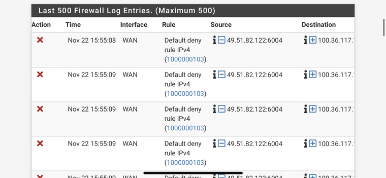

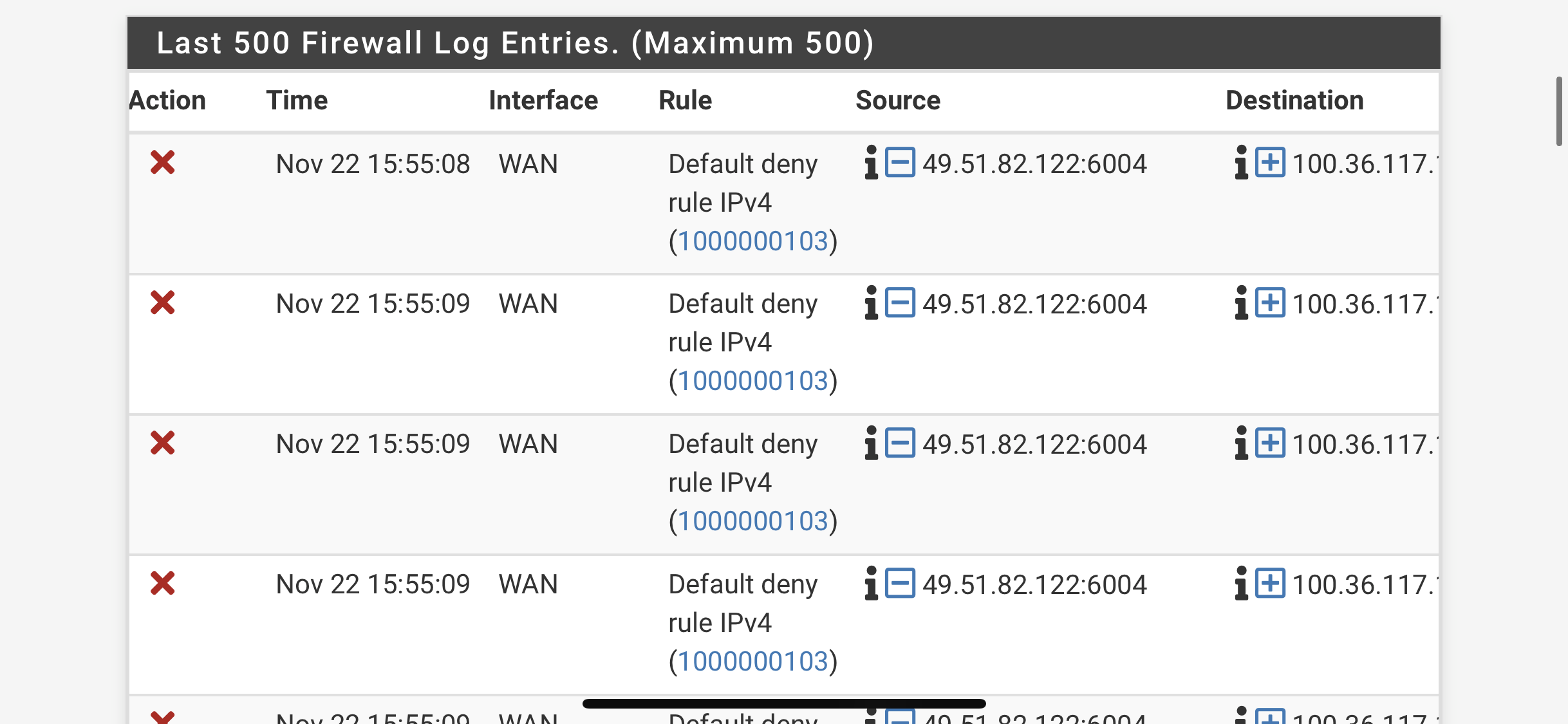

            I'm not sure if it's the correct way but if I go to "Status/System" and then click on "Firewall", I see a lot of log entries (see attached a few ones).

              Yes, the correct place to look. Those blocks are all on WAN though which is expected. Unsolicited incoming traffic from the public Internet should be blocked.

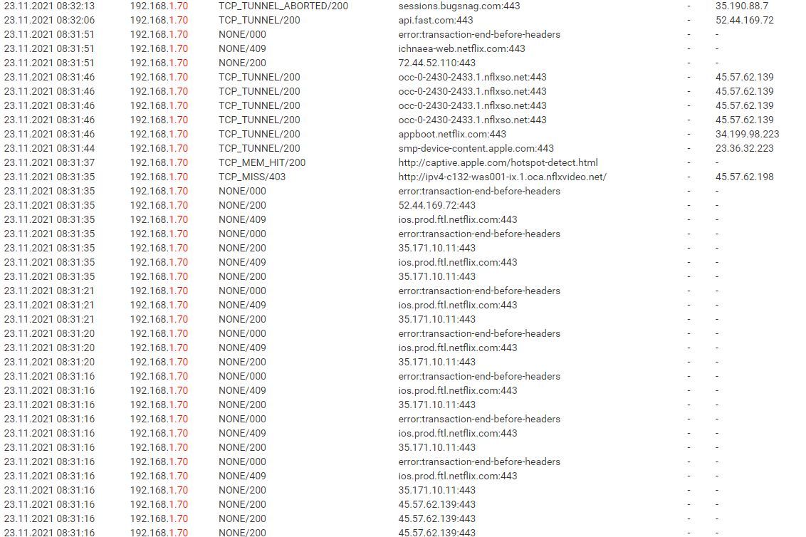

                    I've reviewed on the Real Time log and didn't see this error when I had an issue for example with Netflix, which I launch from device 192.168.1.70...
                    Here are 2 screenshots showing what happened if you see anything weird.

                      All of those lines showing NONE/409 are that issue.
                      make sure both Sqiud and clients are using the same DNS. And preferably that should be Unbound in pfSense so the results are cached and both get the same thing.

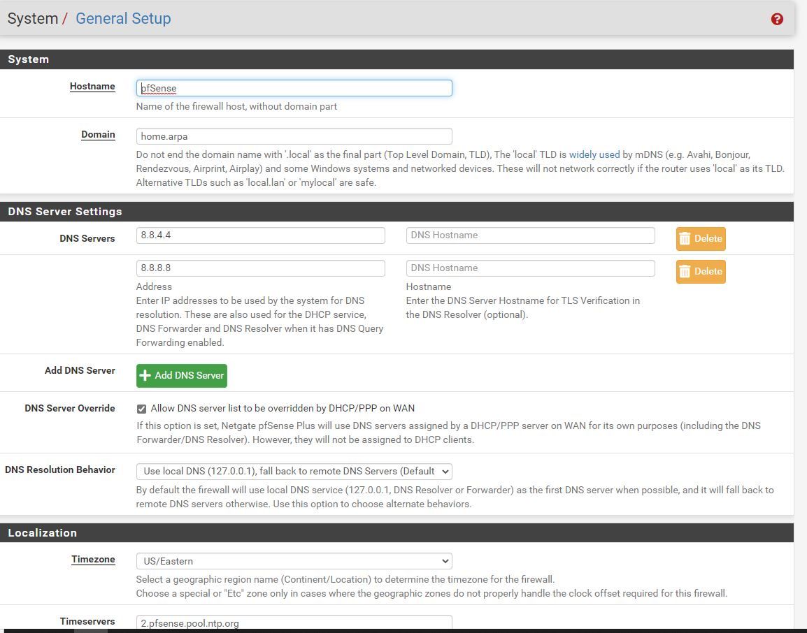

                        I've looked for DNS in both Squid and General Configuration...I think -but am not sure- that they are the same since there is nothing filled in Squid/Use Alternate DNS Servers for the Proxy Server... Below screenshot.

                          Mmm, do you have the DNS Resolver in forwarding mode? Check: Services > DNS Resolver.
                          By default it's in resolving mode so it resolves directly and ignores whatever you have set there in general setup.
                          If it's in forwarding mode it will use the servers configured there (Google's DNS) except you have
                          'DNS Server Override' enabled so you would be using whatever your ISP is passing you.
                          I would try setting 127.0.0.1 in the Squid DNS settings to be sure it is using Unbound (the Resolver) and not Google.

                                      So I don’t have error 409 or at least don’t see it often but have this error:
                                      NONE/000 error:transaction-end-before-headers
                                      Magbe it helps?
