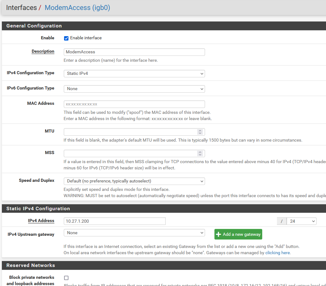

      Hi, I am trying to reach my DSL modem's LAN-facing interface from my pfSense network.
      I've followed the instructions multiple times (reinstalled and factory reset pfSense several times) here https://docs.netgate.com/pfsense/en/latest/recipes/modem-access.html
      OPT1/"ModemAccess" interface is set via STATICIPv4 to: 10.27.1.200/24
      pfSense network: 10.27.27.0/24 (subnet 255.255.255.0)
      Modem's interface: http://10.27.1.1 (subnet 255.255.255.0) so I believe the modem network should be 10.27.1.0/24
      I can't reach the modem's interface.
      I originally had the modem's interface set as 192.168.1.1 (255.255.255.0), same pfSense network, and same inability to reach the modem.
      The NAT rule is confirmed as the top/first rule.
      I am unsure if there is some other configuration, port setting, or something about the NAT rules (based on the information as above) that I am configuring incorrectly.
      Any help is appreciated.

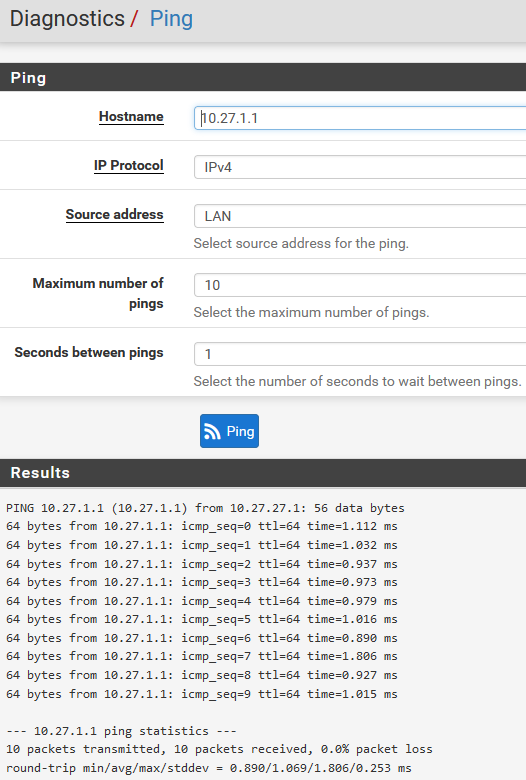

          With interface set, and NAT rule in place:
          Pinging modem via Diagnostics>Ping - 0% packet loss
          Pinging modem via terminal/command prompt on multiple different computers - 100% packet loss
            Ok. Try again from Diag > Ping in pfSense but set the source as the LAN interface.
            That will test the outbound NAT rule but not any firewall rules. So if that works look for a bad or missing firewall rule on the LAN.
            If you can post screenshots of your LAN firewall rules and outbound NAT rules we can review them.
            • V Offline
              Var @stephenw10

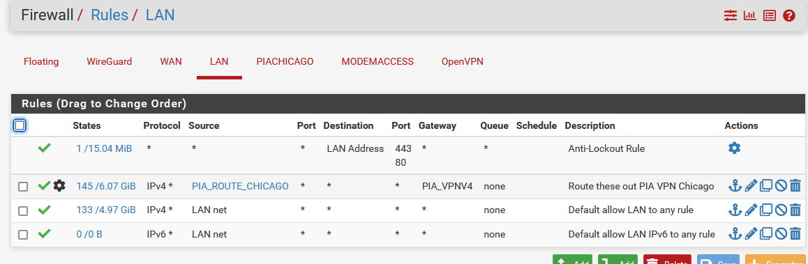

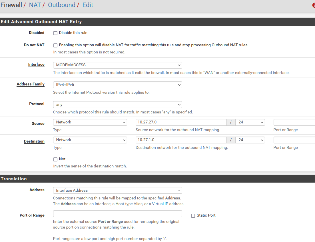

              ModemAccess interface setup included for completeness.
              Note: ALL the PIA and PS4 Pro rules were added long after all my testing for ModemAccess.
              None of the IPs involved in those rules include any computer I have tested access to the modem interface from.
              I had tested both Manual Outbound NAT (per the guide) and Hybrid Outbound NAT, and neither worked. I left it on Hybrid, as I believe this will at least will allow for any possible automatic rules to be setup if I add any other VPN connections.
                Ok, what IP are you testing from that fails?
                Is it in the PIA_route_chicago alias?
                If it is then you will need a more specific rule above that to pass the traffic to the modem without policy routing it over the VPN. That's probably what's happening there.

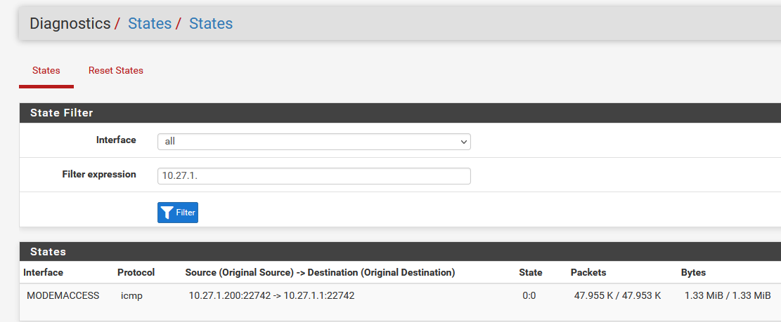

                          Hmm, that sort of timing 'feels' like an ARP issue. But if the modem or pfSense was not responding to ARP correctly they would not be able to ping each other. Check the ARP table in pfSense anyway though.
                          Maybe a bad subnet mask somewhere? Seems unlikely though.
                          • V Offline
                            Var @stephenw10
                            I know for sure my modem's internal interface does not require (or work with) https for access. http only.
                            State table
                            ARP Table entries.
                            I confirmed these were the only mentions in the table, for either MODEMACCESS or 10.27.1.x :

                                Well if it fails again check the states that are open from the internal client IP. You should see the pass state open on LAN and the NAT'd state on MODEMACCESS.
                                You could check that while it is working so you know what it should look like.
