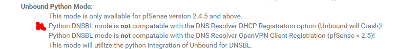

                      This is on one the the reasons pfBlockerNG doesn't want to have this option checked :
                      Just be aware of this effect.
                        Mmm, only in Python mode though, as it says there.
                        I run with DHCP clients registered and with pfBlocker/DNS-BL running and have never seen an issue. I have 25-30 hosts.
                                      Good to know. I was going to setup pfBlockerNG next. I guess I will have to uncheck that box.
                                      @stephenw10 said in Why can't I resolve hostnames for devices on different VLANs?:
                                      How can I check if I am in Python mode? Does this mean I am using Python mode?
