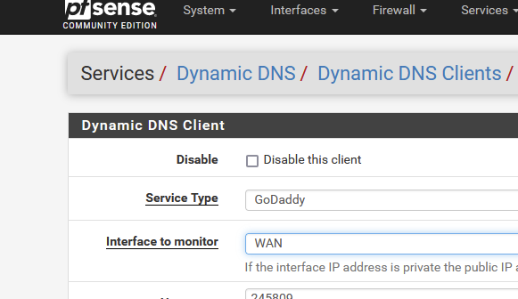

        I've been using pppoe years ago, nad it was the "pppoe" interface you had to select, as this is the outgoint interface, not the WAN interface.
        Select here :
        I've set WAN, you should have a pppoe interface.

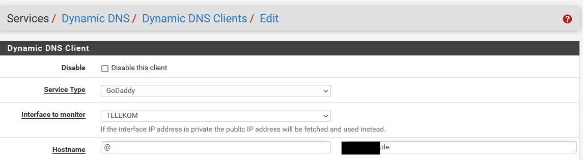

          sttwebs @Gertjan
          @gertjan
          Sorry, should have mentioned that before, I did set the PPPOE (named Telekom) as my device. WAN is serving only as Layer 1 connection (so to say)
