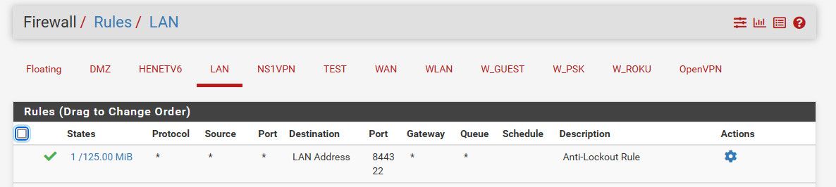

      Your going down the wrong rabbit whole - if you have the antilock out rule there, blocking rfc1918 is not preventing you from access the gui.. You have something else going on. Like the gui not even running or working maybe?
      SG-4860 24.11 | Lab VMs 2.7.2, 24.11
      S 1 Reply Last reply Nov 10, 2021, 2:10 PM Reply Quote 0

          @sergei_shablovsky what port is gui listening on?
          [21.05.1-RELEASE][admin@sg4860.local.lan]/root: sockstat | grep :8443
          root     nginx      61483 6  tcp4   *:8443                *:*
          root     nginx      61483 7  tcp6   *:8443                *:*
          root     nginx      61230 6  tcp4   *:8443                *:*
          root     nginx      61230 7  tcp6   *:8443                *:*
          root     nginx      60962 6  tcp4   *:8443                *:*
          root     nginx      60962 7  tcp6   *:8443                *:*
          You know you can just reset all of that from the console menu, and even just rollback to previous config.
          S 2 Replies Last reply Nov 11, 2021, 4:38 AM Reply Quote 1

                                          johnpoz LAYER 8 Global Moderator @Sergei_Shablovsky
                                          @sergei_shablovsky What exactly are the rule(s) they enabled. Because I still do not get what the issue is here. When asked if they also disabled the antilock out you stated no.
                                          It is not possible to block your lan network from accessing the gui with the antilock out rule there - that is the whole point of it!!
                                          Sure you can block internet access, and you could block dns doing that - but access to the pfsense lan IP on the gui or ssh port would still be allowed by the antilock out..
