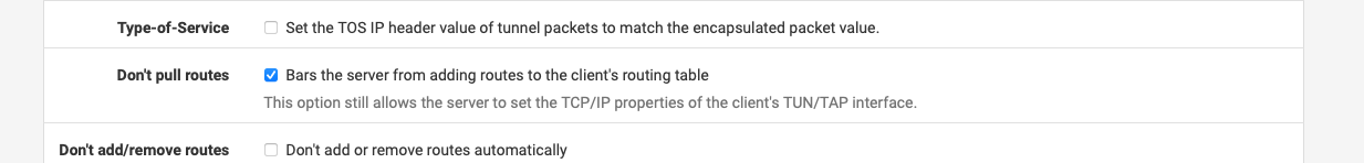

              Do you have don't pull routes set ?
              I'm guessing your default route is via the VPN.

                  Lockie @NogBadTheBad
                  @nogbadthebad "Don't pull Routes" is ticked
