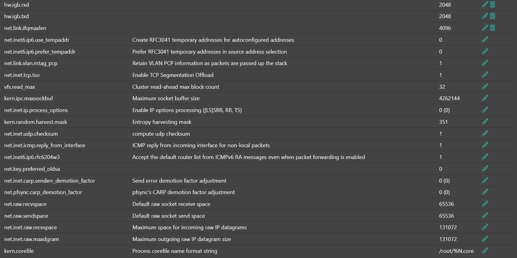

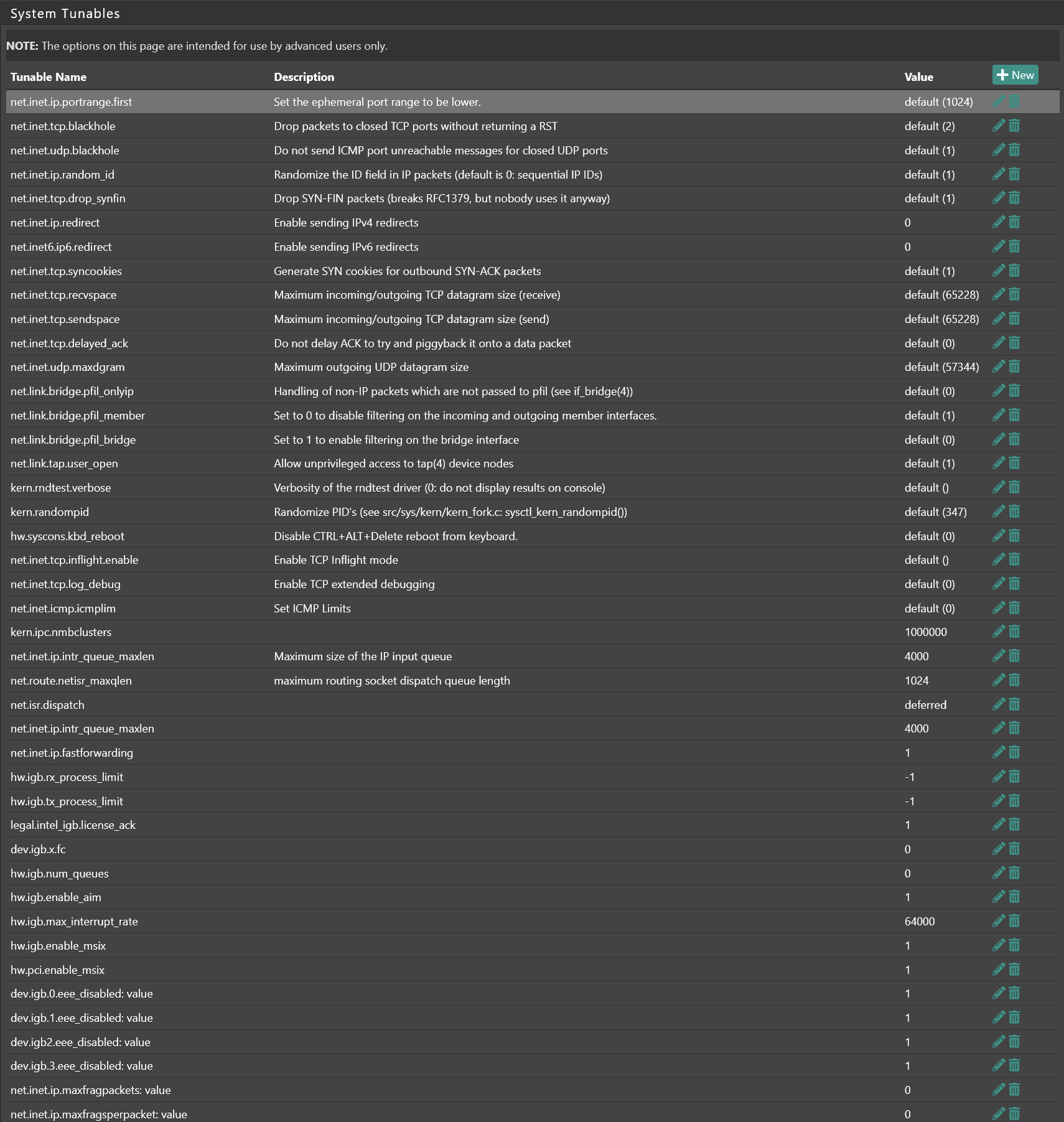

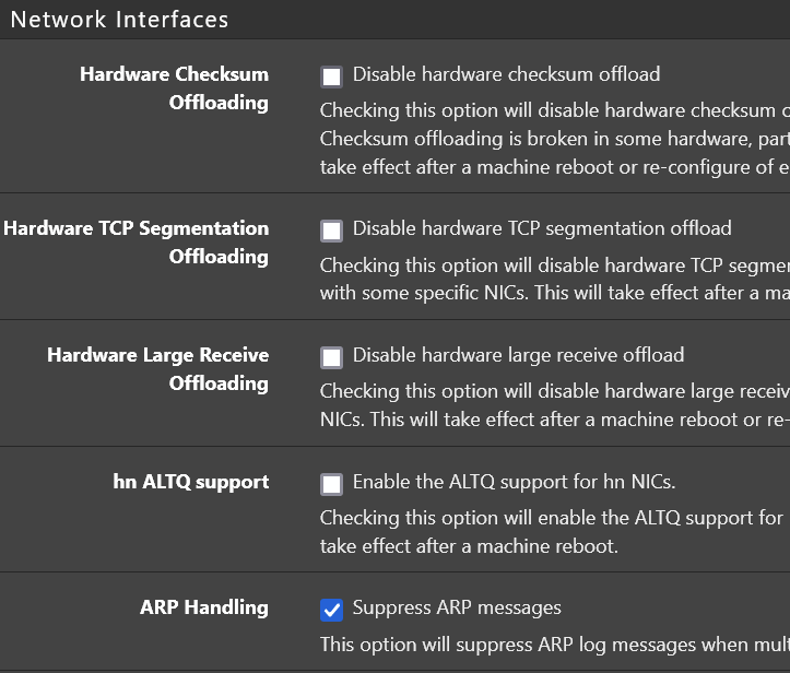

      All network offloads enabled and some additional tuning system tunables set:
