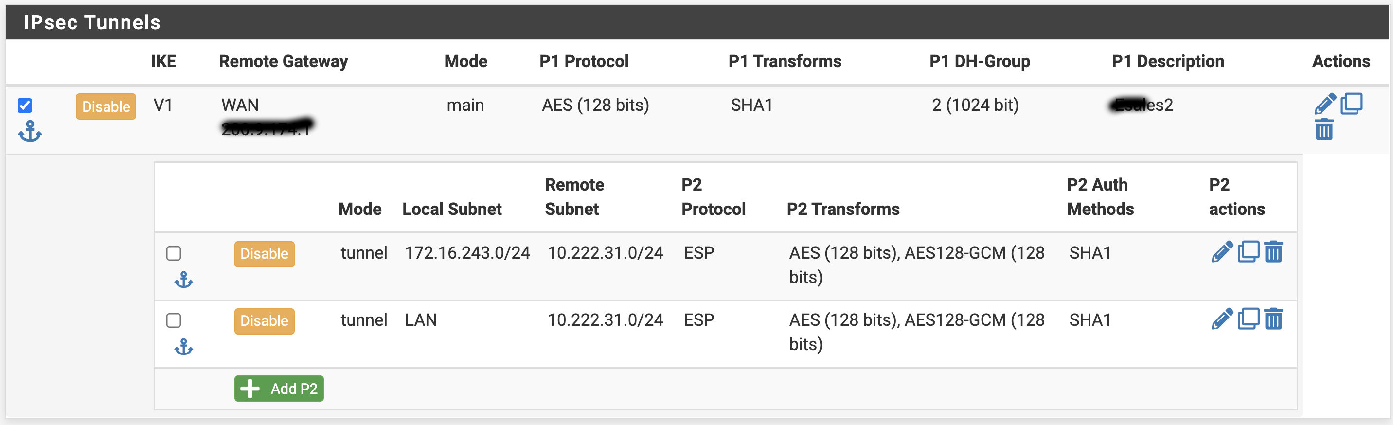

After update from 2.4.5 to 2.5.2, I got this strange behavior from IPSec:
I have a Tunnel with a P1 and 2 P2. When I try to connect it, in the overview pane, I get two P2 connections of the same P2 (see the below images)
@jimp in Version 2.6.0 this is not happening. Its just working as it should.
I tried to make big differences in the phase 2 entrys but they always get replicated. Iam trying to establish an Site 2 Site with an Sophos UTM latest Firmware. With 2.6.0 and above there is no problem, with 2.5.2 i have no luck in doing so...
is there an workaround ? i need this to work ...
