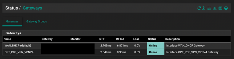

                I'm pretty sure I don't have any extraneous gateways defined. Here's what shows up under Status > Gateways
                No IDS/IPS running either.
                  Hmm, OK that looks fine.
