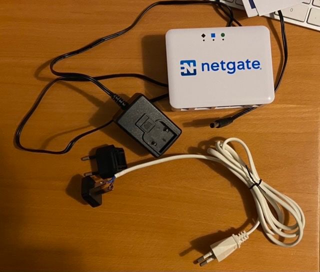

      I found this topic about SG-1100 power supply. Mine is quite finicky and it’s all because of the EU pin accessory. When I attach the US pin and wire it the device gets power.
      Anyway I do have a box of unused power adapters and I found one that outputs 12V / 1A max. And another one that outputs 12V / 0.5A max.
      12V x 1A = 12 Watts max, which should be fine as the SG-1100 consumes less than 5Watts.
      So could I simply use that power adapter? Or is it better to issue a ticket at Netgate support?

        @cabledude Perhaps an US to EU converter for the plug?

          @andyrh Good idea and certainly feasible. But I don't have one of those lying around. Adopting one of my idle power supplies would be much easier.
          I just opened a new ticket at Netgate support. Let's see what they say.

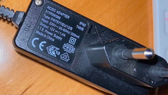

                  I went through my old adapters again and look what I found: here is the power supply belonging to an old fritzbox router. 1.4A. That would give me some room for peace of mind. What do you think?

                    mer @Cabledude
                    @cabledude Ahh, so you grab the beer mug two handed :)
                    If the other end fits the 1100 correctly, it winds up in the middle and should be fine.
                    Worst case is the 1100 doesn't have enough power under load and it shuts itself off.
                      I would expect that to be fine. But I can't really condone using anything but the supplied PSU as that's what the unit is tested with. Anything else is outside the warranty.
                      The supplied PSU has to be capable of powering the unit at maximum load and that includes both USB ports supplying 500mA (at 5V) and the internal mPCIe slot populated. It's unlikely you would ever see that in normal use.
