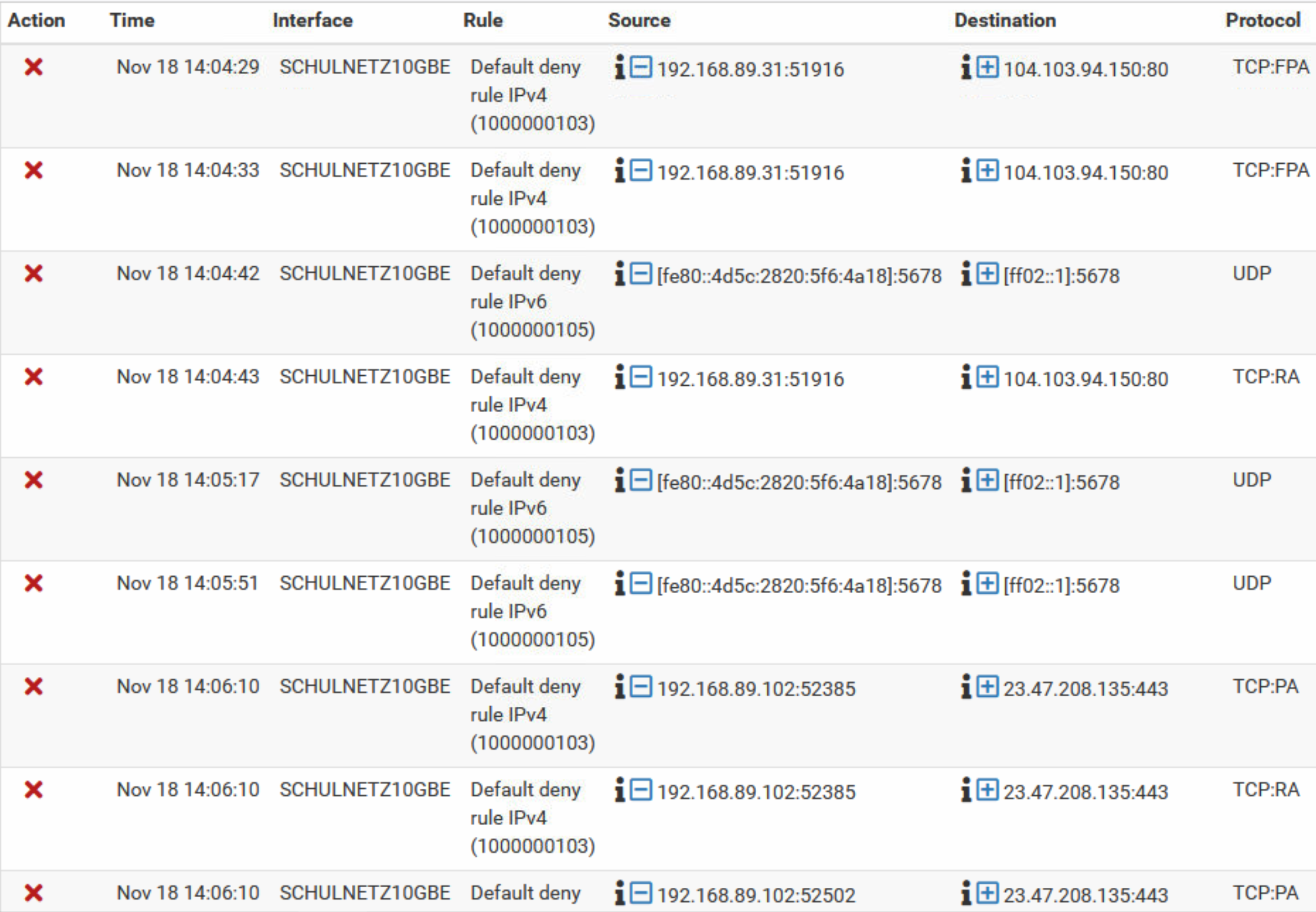

      I take a look in the system firewall log:
      I see a lot of blocked :80 and :443 communication .. but from LAN to WAN should be no blocking.
      Could this the problem?

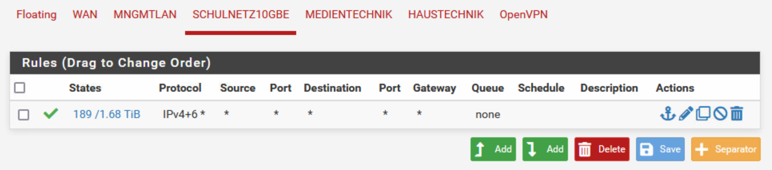

      VLAN 300 "Schulnetz10Gbe"

      • stephenw10S Online
        That blocked traffic is not the problem. It's all TCP flagged traffic which is expected:
        https://docs.netgate.com/pfsense/en/latest/troubleshooting/log-filter-blocked.html?highlight=blocked#troubleshooting-blocked-log-entries-for-legitimate-connection-packets

            Gertjan @unique24
            @unique24 said in WhatsApp could not sending, but receiving:
            When I know my phone IP I could check the logs, right?
            When your phone uses wifi connection, and the AP you use is connected to VLAN300 interface called SCHULLNETZ10GBE, then there won't be any log to see as the one and only "pass all" rule that is present on that interfaces passes all traffic without logging.

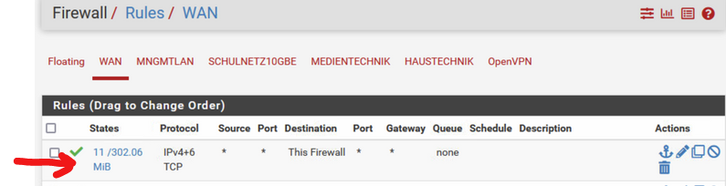

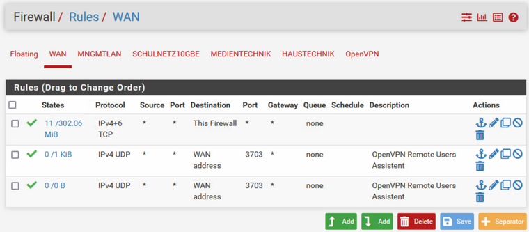

            And rule 3 is identical to rule 2, so it will never get hit/used.
            U 1 Reply Last reply Reply Quote 1

                  Gertjan @unique24
                  Should I remove the rule? I thought I need it to pass the traffic to the internet.
                  When you installed pfSense, there was no rule whatsoever on the WAN interface.
                  And everything was fine : every LAN device had Internet access.
                  When you activate an OpenVPN instance, listening on the WAN interface, port 3703 UDP, you need a firewall rule "port 3703 - UDP" on the WAN interface.
                  One rule, not two.
                    You should not need any rules on WAN to allow access via Teamviewer.
                    The internal host connects out to the Teamviewer servers and that's how your remote client then finds it.
                    • U Offline
                      unique24 @Gertjan
                      @gertjan Thank you .. I thought I need to open the WAN port with this rule.
