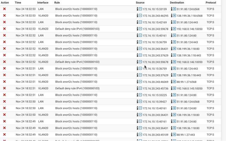

        Can we see screenshots of the firewall and NAT rules you have in place?
        Do you see traffic blocked in the firewall logs?

          Yes, there are many IPs blocked.
          138.199.36.0/24
          136.243.39.0/24
          And many others.
          I would like to let snort ignore all the IPs related to AnyDesk.
            Are those inbound or outbound? On which interface?
            Screenshots are much easier to convey all the information.
              Alessio @stephenw10
              172.16.10.15 and 172.16.20.243 are my client/server in lab.
              Almost all the destination address are anydesk IPs.
                Ok, so you can see Snort has blocked most of that traffic.
                You should clear the clear the Snort Blocked Hosts list and retest with Snort still disabled.
                If that works you need to correct your network definitions to prevent it blocking internal hosts.
