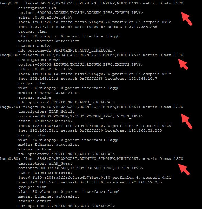

                          seems you are pointing in the right direction. Indeed I have one interface where I adjusted the MTU (SDWAN to China) but on all other interfaces the MTU is default. But it seems that with the upgrade the MTU from the SDWAN interface is now set on all other interfaces. (ifconfig shows my SDWAN MTU on all interfaces)

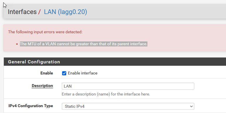

                          I tried to set a MTU on the LAN interface but i get an error: The MTU of a VLAN cannot be greater than that of its parent interface.
                          Where can I set the MTU of the parent interface?
                          • T Offline
                            Trinity99 @stephenw10

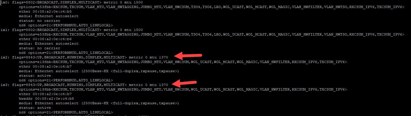

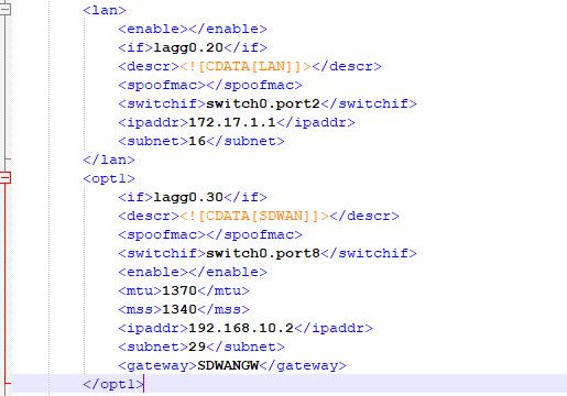

                            according to my config only one interface have a changed MTU (see screenshot 1 below)
                            ifconfig shows me that ix2 and ix3 have MTU of 1370 and all lagg interfaces (see screenshot 2 and 3 below)

                                Yes so normally the interfaces inherit the MTU from parent. Doubly here since you have VLAN on a LAGG made up of real NICs. So in order to allow you to set an MTU pfSense applies the MTU to the parent interfaces and their parents which results in all the subinterfaces also having that applied.
