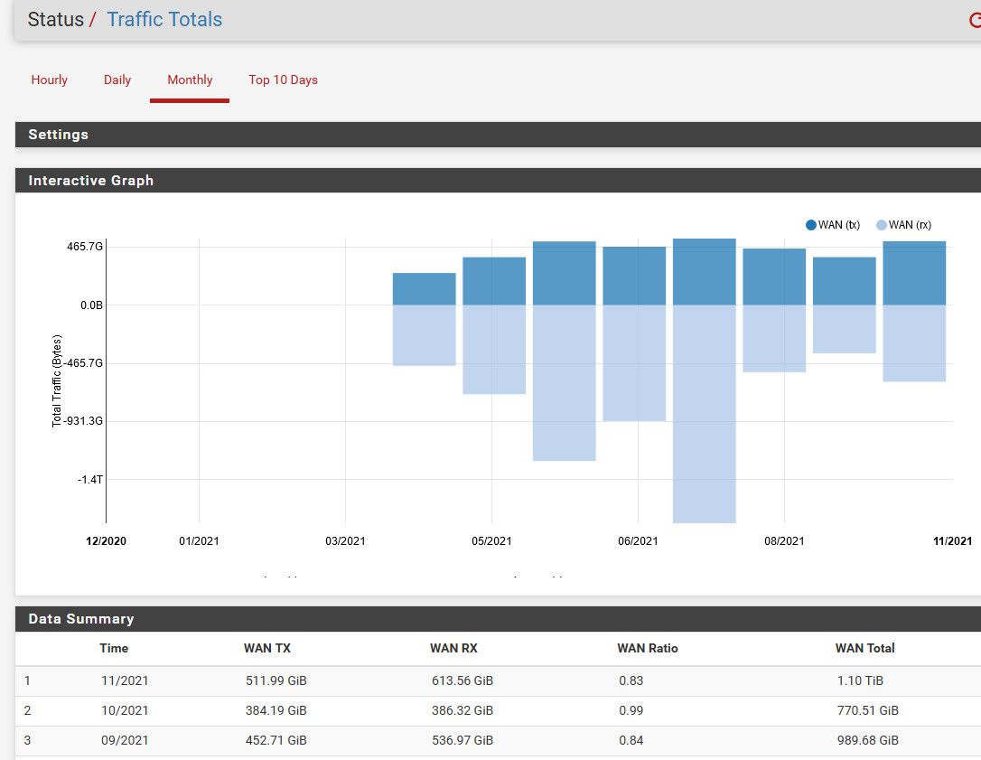

        @m0snr Well you should be able to just look at the status of your interface and get a total counter in packets which would give you a hint to if you moving any amount of data... Keep in mind there is a quality check that would be running, it defaults to zero data.. But still something moving back and forth that could use up your data..
        In/out packets
            356808060/343365930 (388.44 GiB/339.52 GiB)
        In/out packets (pass)
        The monitoring graphs will show you bit rates over time.. And the package "Status_Traffic_Totals" is prob of interest to you.
