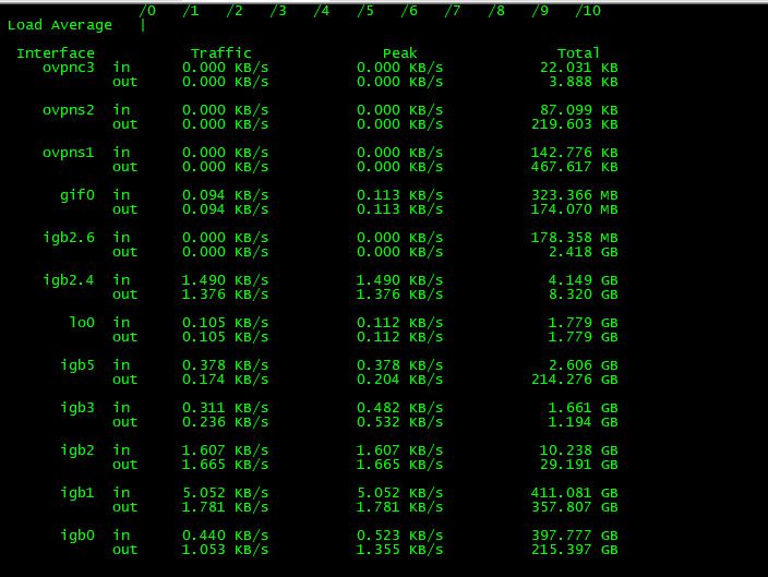

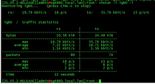

        johnpoz LAYER 8 Global Moderator @andy_redpoint
        @andy_redpoint you prob what to take a look at
        systat -ifs
        or vnstat is useful for this as well with the live output
        A 1 Reply Last reply Reply Quote 2
          andy_redpoint @johnpoz
          @johnpoz Thanks, that's great and solves my problem.
