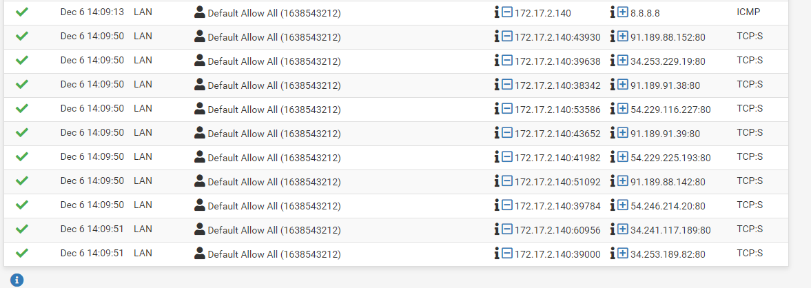

      I can connect to all instances on the lan subnet and in all my vpcs. However I cannot connect to anything from the lan instances behind pfsense. If I ping 8.8.8.8 I get no response but the icmp is logged as allowed traffic. The same happens if I try to connect to other vpc instances. It gets logged as allowed on pfsense but I fail to connect.

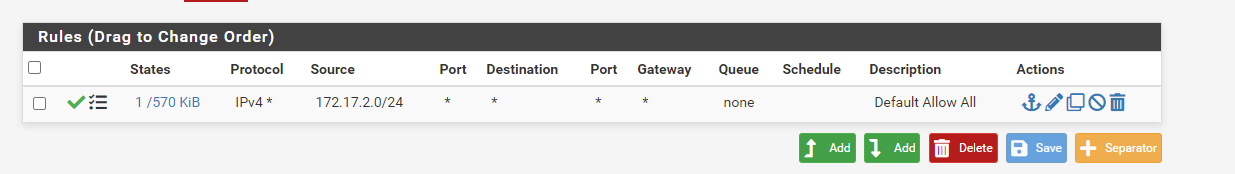

        Can we see your LAN side rules and the logs showing it passed?

          Below are the logs for a ping to google and a apt update on a host on the lan.
          Currently there is a single allow all rule on the lan interface.

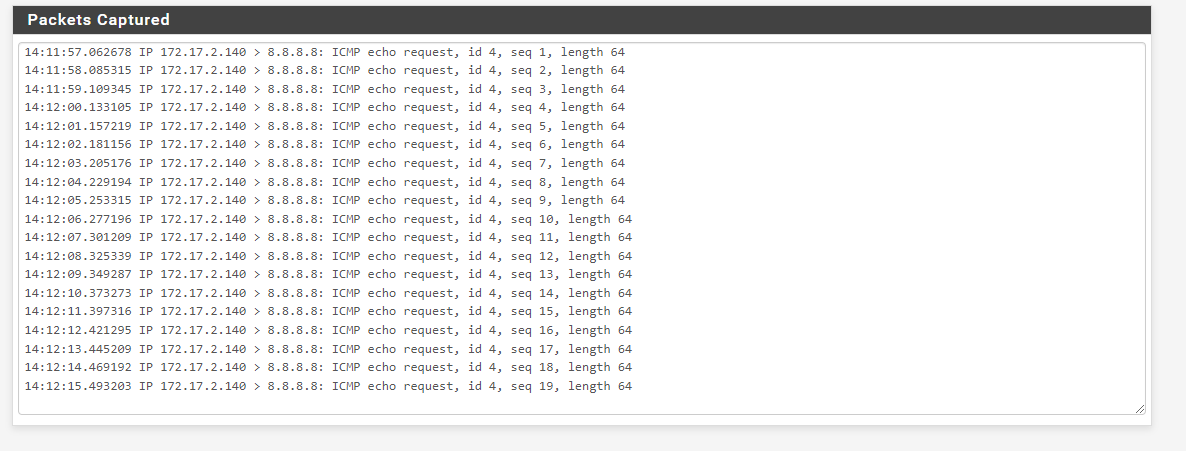

          Finally there is a capture of a ping to 8.8.8.8 from a host on the lan.

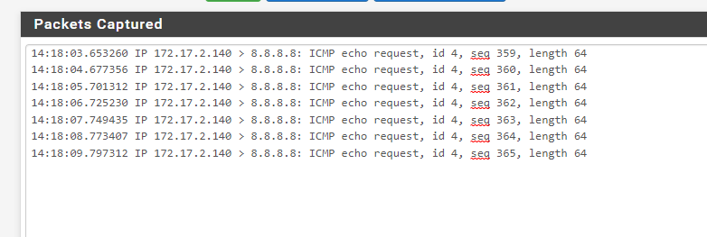

            Just to add I do see the ping on the WAN interface
              stephenw10 Netgate Administrator @Paddy
              Ah, OK. On the WAN interface you should usually see that leaving as translated to the WAN IP by the outbound NAT rules.
              If it's not translated there it would need to be added to AWS to translate at the external elastic IP. However that's probably not what you want sine the AWS would know about both subnets and you could easily end up with an asymmetric route.
