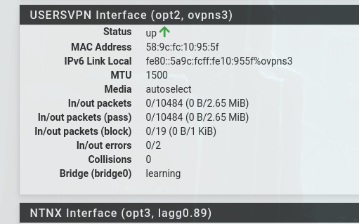

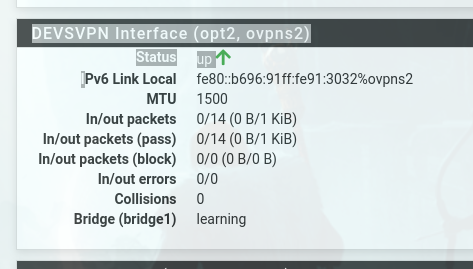

          I did compare the configuration and found that some Openvpn interfaces were slightly different between the two FWs. The Master FW was showing a MAC address for the ovpns2/ovpns3 interface whilst the seconday FW did not show a MAC address:
          Master FW opvns3 interface:
          Secondary FW opvns2 interface:
          Maybe above is unrelated but that was a strange difference also cause those interfaces on the master FW were showing a "Speed and Duplex" drop down menu (not shown on the Backup FW).

            Mmm, the config should be identical otherwise the state sync will be incorrect. That's unlikely to really be an issue on OpenVPN servers though as only one can ever be active and clients have to reconnect at failover anyway.
            The presence of a MAC address indicates the server is running in TAP mode. They should both have one if both are TAP mode servers and both are running.
