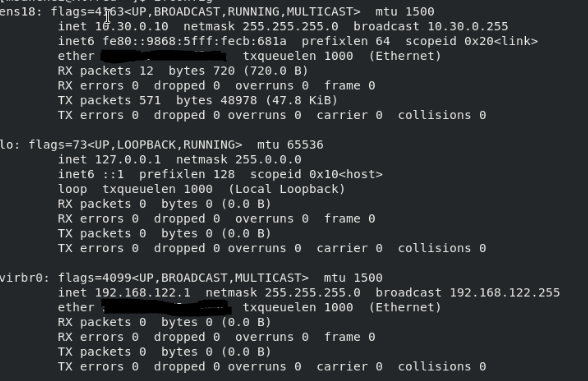

                            Thank you for the reply, that's one more step closer! Sadly, it did not fix my issue. I also spun up a VM in that host to see how the IP looked, and this is what I get. I'm not sure what that virbr0 connection is all about but it's getting a 192.168.0.0/24 instead of the 10.30.0.0/24
                            • P Online
                              Patch @Misinthe
                              @misinthe
                              in a Proxmox console try
                              systemctl restart networking
                              Doing so also fixes Proxmox networking for me but corrupts
                              reboot
                              But if you have a physical console connected to Proxmox you can get and idea of what is happening and after reboot is done a few times it seams to settle down again until the next change to network configuration involving Proxmox.
