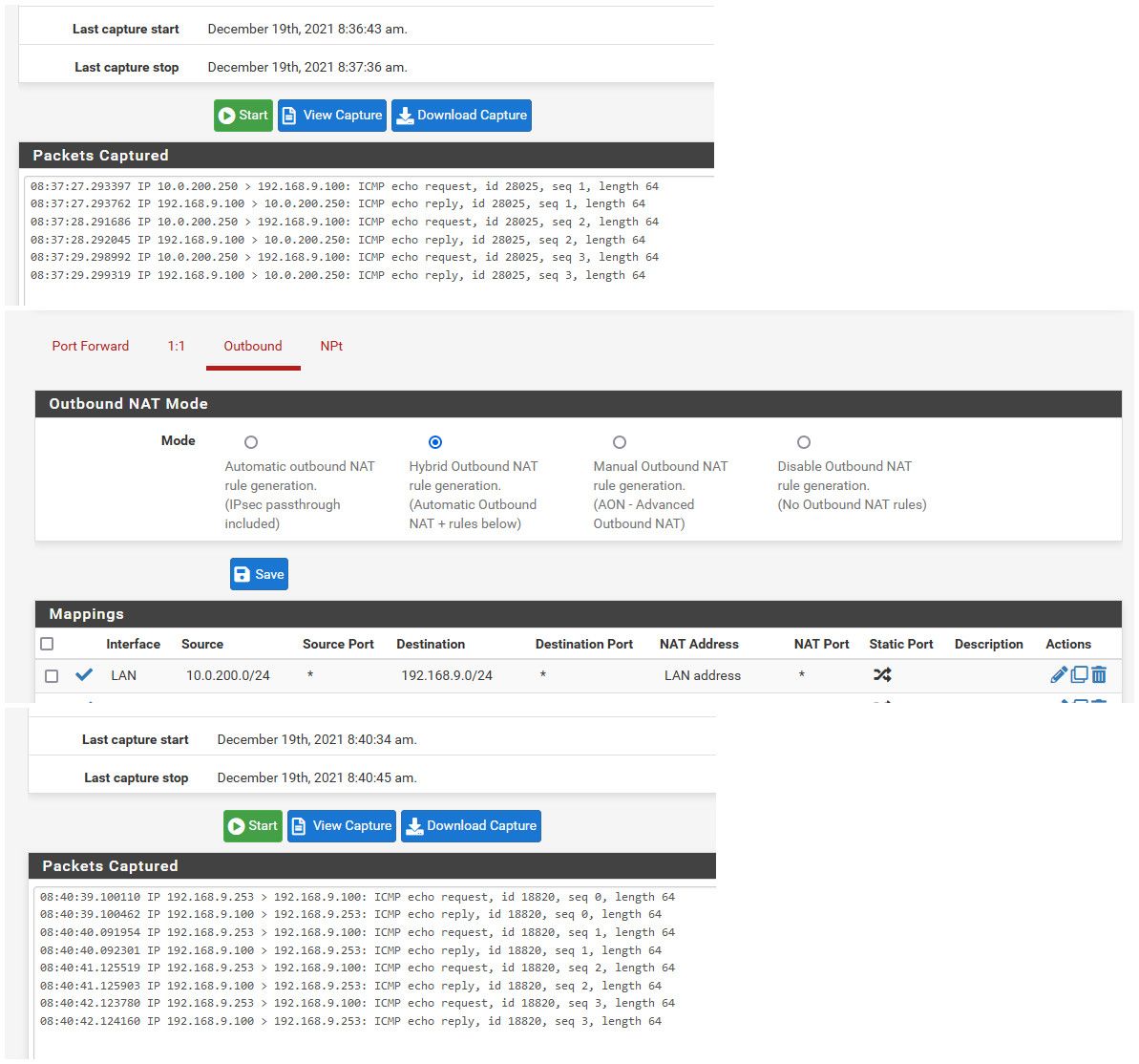

          johnpoz LAYER 8 Global Moderator @swansense
          @swansense said in NAT vpn if connection to a specific host.:
          Is it possible to configure Pfsense to NAT the connection and use a local lan IP when NATing if i a connection from the VPN network is trying to access this machine.
          Yeah you can do that, just create a outbound nat on the interface this device is on, lan I would assume. With destination to that specific IP source of your vpn tunnel network, using the lan address as the address.
          This will make it look like to the device your coming from your pfsense lan IP vs the IP of the vpn client tunnel network IP.
          If need be I could setup an example with my vpn showing you pictures..
          edit: Here you go just did example anyway. So pfsense lan IP is 192.168.9.253, my tunnel network for vpn is 10.0.200/24 - so at first you can see my vpn client pinging host on my lan network 192.168.9.100 coming from 10.0.200.250..
          I then created the outbound nat on the lan interface. Now the pings come from pfsense IP vs the vpn client IP.
          You could get specific with the destination, for example I could of used specific 192.168.9.100/32 as the destination vs the whole network..
          S 1 Reply Last reply Reply Quote 2
