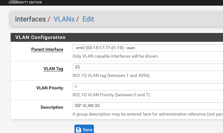

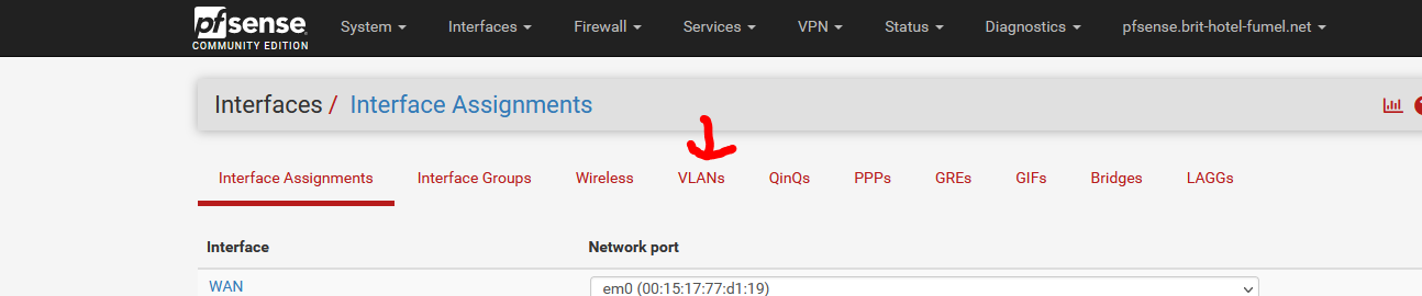

        Their is VLAN support :
        Basicly, it goes like this :
        Your pppoe uses a VLAN. This means you can't use the pppoe setting of the WAN interface, you have to set up a VLAN with the coorrect VLAN number first :

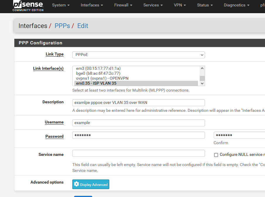

        Now, create a pppoe interface that uses that VLAN :

                    I guess so! I just plugged everything is exactly as shown in the super awesome mega helpful screenshots above, and it worked instantly. ๐Ÿ˜Š
