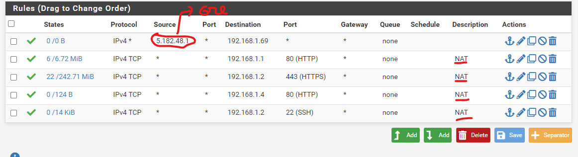

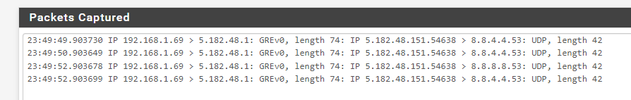

      LAN -> WAN

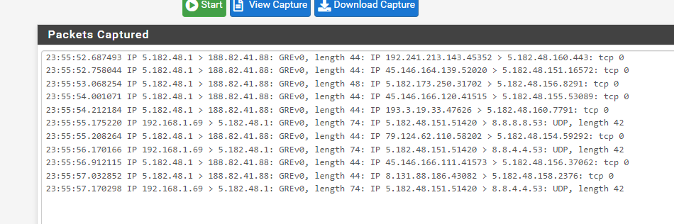

      WAN -> LAN
      LAN Firewall Rules

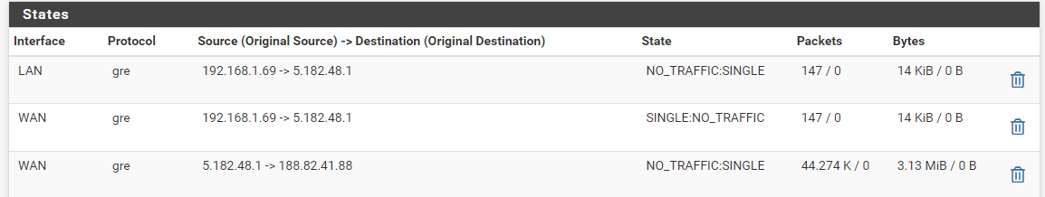

          s_serra @stephenw10
          these are the states of the gre
            stephenw10 Netgate Administrator @s_serra
            It's not NATing the outbound traffic on WAN so there's no translation state to accept the incoming packets. In inbound state on WAN is the other side also trying to establish the unencrypted tunnel.
            Check your outbound NAT rules.

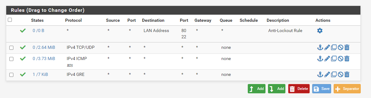

              s_serra @stephenw10
              this is wan's firewall rules
                It doesn't look like there's a port forward associated with that rule on WAN so it shouldn't be there.
                Check the Outbound NAT rules in Firewall > NAT > Outbound
                Something is allowing that inbound state on WAN to be created without NAT and that may be conflicting with the outbound state preventing it.
                You don't appear to have a rule on WAN that would allow it so check the floating rules too.
