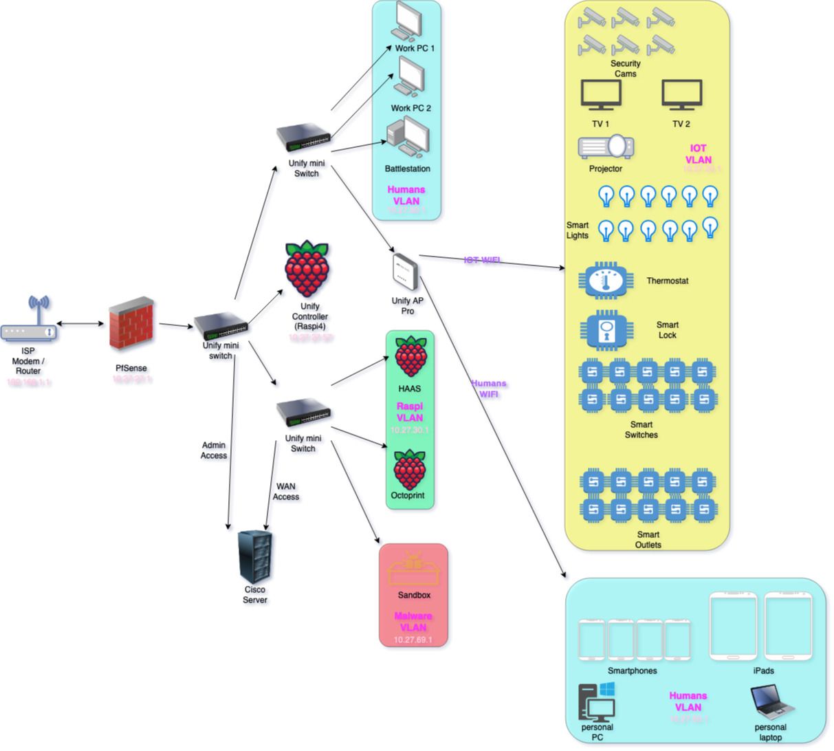

I have a combination of DIY/open source devices:
AWOW mini pc 6GB DDR4 ram, 218gbSSD, Intel Celeron J3455 as the PfSense box
raspberry pi 4 (4GB) as the Unify Controller
3 of the unify mini switches to distribute lan through house
unify AP Pro - segmented into two different WiFi's on separate VLANSnetwork is setup as follows:
lan / admin - 10.27.27.1/24
iot - 10.27.20.1 /24
rapberry pi - 10.27.30.1/24
humans - 10.27.50.1 /24to access my pfsense instance I could go to 10.27.27.1 when I'm on lan or 10.27.50.1 when I'm on humans.
to access my unify controller I go to 10.27.27.57 only accessible from LAN/admin.
I have other raspberry pis and they're segmented to their own VLAN. I did the routing and rules for all of the devices, it was fully operational.Here is where my problems start. I was under the impression, that all I had to do was plug in a WAN cable into my pfsense box, and the network at the new house would work the same as it did at the old one. my how I was mistaken. :(
When I plug in the WAN cable from my ISP modem I can access the internet, but get quarter speed of what I'm paying, not worried about the speed atm. however if I plug in directly into the firewall I my ip address is on the 10.27.27.x subdomain. if I plug into certain ports on my mini unify switches I get the 10.27.30.x subnet, because that's how they were setup before, and one or two of the ports are on the 10.27.50.x subnet. something weird I noticed, some of the ports were on the 192.168.xxx.xx subdomain. see figure below
192.168.1.x (ISP Modem) --> 10.27.27.x (PfSense)--> when plugged into pfsense box
192.168.1.x (ISP Modem) --> 10.27.27.x (PfSense) -->10.27.30.x (mUnifySwitch)-->when plugged into certain mini switch ports
192.168.1.x (ISP Modem) --> 10.27.27.x (PfSense) -->10.27.30.x (mUnifySwitch) -->when plugged into certain mini switch ports
192.168.1.x (ISP Modem) --> 10.27.27.x (PfSense) -->192.168.2xx.x (mUnifySwitch) -->when plugged into certain m switch ports
192.168.1.x (ISP Modem) --> 10.27.27.x (PfSense) -->10.27.50.x (mUnifySwitch) -->169.x.x.x (UnifyAP)-->when connected to AP with no internet
I had the AP plugged into the 10.27.50.x port on the old network and everything worked fine. I tried doing the same today, and the IP address reads 169.x.x.x. and no internet access when connected to the AP.
Another issue, I cannot access the firewall, unify controller, or my raspberry pis, regardless of which VLAN I'm on.
I have tried plugging the AP into all the ports on the different switches and cannot get internet access when connected, when I try to connect a to the AP from a phone it fails saying "Fail to obtain IP."
