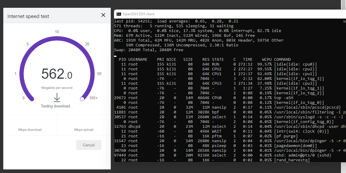

sorry that was it idling here's one while I'm running a speed test. Noticed how I drop to around 500Mbps now
Mmm, nothing unusual there either. No CPU core maxed out.
